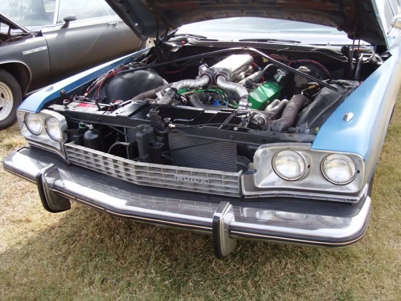

    Dual Turbos! OMG!!! I'd just like to find room in mine to get one turbo on it!:rofl2::thumbs2:

    If I had a couple of grand laying around to "blow" [get it?] there is a guy who sells twin turbo kits for the Buick 350, all custom made part, direct bolt in type of kit. All but the carb/or EFI.

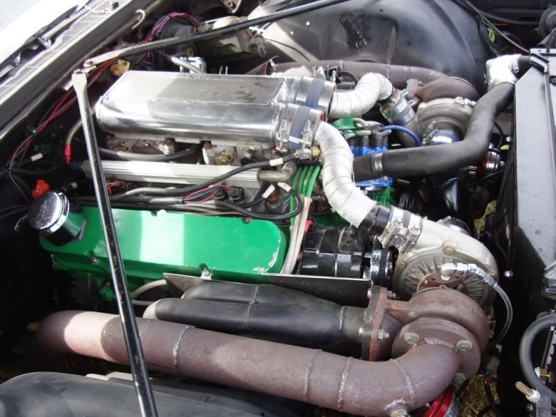

    What engine is in there?
    What times was he running?

    Although those pictures are a tease, [no times] that's a BB Buick!?!?!
    I'll take a stab @ low 10's - high 9's if he got it to hook-up and stay together, but without a cage, he's restricted to 11's, at most tracks!

    What the H-E double hockey sticks is the motor in that thing? I wanna do up my '73 as a pro street.

    I think it might be the 215cid aluminum turbo V8 from back in the day?? ;)

    Harry - please sent times and mph on this thing - I'd be real interested!

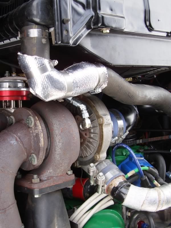

    Those flexible tubes to the air cleaner - should be solid for air flow.
    Are those Edelbrock [carter] carbs? Blow-through, I hope!
    How big is it?
    What cam?
    Trans?
    Gear?
    Turbo size?
    Inquiring minds wanna know!

    Nope, it's a 455. I do have a couple of 215s stashed, though!
    455, still has stock rods and crank :shhh:
    It's fuel injected. Those are holley carb baseplates bolted to the bottom of the airbox. (too cheap to buy real throttle bodys!)
    It's a smallish lunati cam, 110° lobe centers, about .500 lift.
    Th400 trans with a 3.50 rear gear.
    To4E turbos.
    Ran an 11.76 this year weighing 5315lbs.
