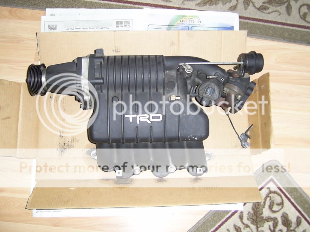

    To prepare for boost.... 255lph Fuel Pump, SAFC for Air/Fuel Ratio Tuning, Knock Sensor Relocation (Common problem in 1MZ's).
    Purchased a TRD M62 Supercharger for the 1MZ-FE for the 99-01 Solara TRD. The engine is the same as my Camry except minor intake differences. Install was a breeze and install was done in about 6-8 hours. I kept my boost at 4psi (Stock Pulley) for now but i have intentions of getting that higher soon.

    Occupant, yes the TRD Supercharger is extremely rare. It has been discontinued ages ago by TRD and was available only in the US for the Solara, the 97-01 Camry and the Sienna. It cost me a LOT but the pleasure of having a original car was well worth the cost. These still go for 2.5k to 3k easy. The site solaraguy.com (gen1-1.5 for sale forum) has lots of S/C's for sale usually. But if you live near Maine... contact Gabe Potter of GLP Motorsports (Find him on Facebook). He has ALL the performance options for the 1MZ, including a 3MZ/1MZ 3.3L motor for a swap, used TRD Superchargers like mine and custom MP90 Superchargers. He also makes Twincharged setups, and has even built a triplecharged Solara (twinturbo + M90 Supercharger) with over 450whp at low boost.
    The problem is mainly with the E153/E53 Manual Transmission from the Camry V6 which is really rare and usually taken out of MR2 Turbo and Manual Solara V6.
