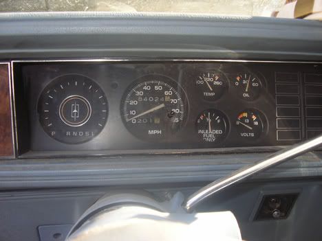

    Hey guys, just wanted to start a thread of my project. Meet "The Pumkinator", my 1979 Olds Cutlass Cruiser that I picked up about 5 years ago. After a bit of tweaking and wrenching I've been daily driving it as my business hauler since that time, and decided recently it's time for a major overhaulin'. Hope you enjoy, as usual any comments/suggestions land on open ears...
    Here's the car right after purchasing.

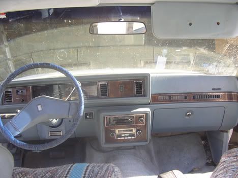

    Light Blue vinyl interior
    8-track AM/FM stereo (still works!)

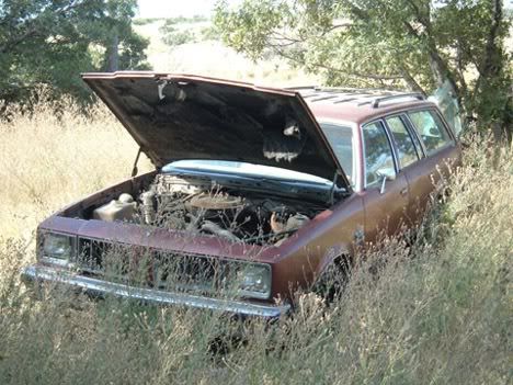

    Next on the list was new front end to pass our state's safety inspection. After a few days of searching I found a '78 Cutlass Cruiser in a farmer's field just a few miles from my place. Body was rusty, interior was hammered, but it had a transplanted Chevy 350/TH350 and a good front nose section. The guy told me they quit driving it because the trans was slipping. "How much you want for it?" I asked, "Oh... I'll take $75." Wasn't long before it was on a tow dolly on the way home. I Installed a battery and some gas in the carb and it fired right up! Ran o.k. but was clearly a high mile motor. Pulled and sold it, kept the trans as a core, and yanked the front clip and every other usable part off it before hauling it to the wrecking yard. Got a bunch of parts and made $300 cash off it, not a bad deal.

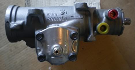

    After about a year of driving it was developing a bad case of loose front suspension and it was also time for a cosmetic upgrade. I picked up new ball joints, tie rod ends and a 12:1 ratio AGR steering box.

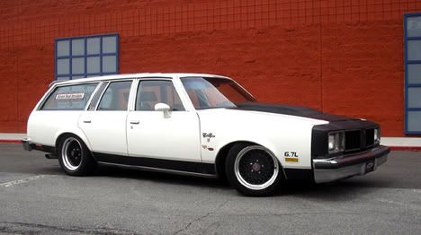

    While I was in there I cut the factory springs to get a feel for the look of it lowered, and added a little more rattle can semi-gloss to hide some paint chips on the lower panels and hood. Here's the end result. It's dropped about 3" out back and almost 4" up front.

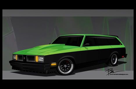

    I should probably intro myself a little here. I've grown up around muscle cars and drag racing and started drawing cars after I read my first "Cartoons" mag around age 12. After some time in automotive retail I got out and put my artistic skills to work and became a graphic designer. When the economy tanked the company I was working for went into the toilet and I found myself along with about 1.7 billion other graphic designers looking for work, a real joke to even get a foot in the door for an interview. At that point I started pushing my side business, Street Rod Designs, to keep $ coming in. In the process of drawing cars of course I've drawn mine. The wagon has gone through 3 different styling changes, but I think I'm finally pretty well sold on the last.
    This first concept quick sketch was a pretty simple idea based on the mid 80's Hurst/Olds Cutlass. 17" Torque Thrusts and a low stance made it shout a bit.
    After a while of looking at it I felt the wagon needed a look that was a little less overdone and a little more aggressive. I really like this style stripe and a med-dark charcoal grey with some carbon fiber accents. I liked this theme but this stripe seemed like it had been done several times and I felt some flash was missing.
    During this time of exploring ideas for the wagon I finally gave up on the graphic design gig and felt it was time to get back to my roots and passion for employment. After a lot of research in schools I decided to attend a "Collision Repair, Street Rod Emphasis" program at a Utah Valley University, only about 20 miles from where I live. Turns out the street rod instructor Cris Bogges and his program have been called by many "the best in the west". I talked with him several times before deciding to hit the books again, and had no idea about his reputation until I started asking around. A real down to earth humble guy with mad fabricating skills.

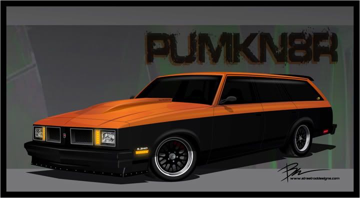

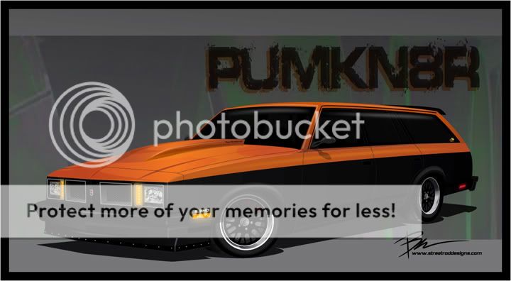

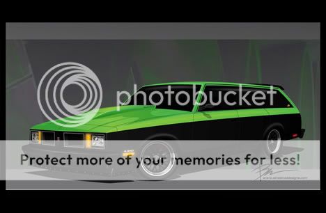

    Since I needed a project to work on at school and the wagon needed a facelift things fell right into place. Ultimately I'd like to work in a shop building killer pro-touring and low-rod style machines so this car is the perfect practice project. Although the grey wagon theme was cool I figured I needed something a little more loud for two reasons- 1. to draw attention to my side business and design skills and 2. to catch the attention of shop owners/ possible employers after graduation. I've always dug the look of old school Mercs and such with a satin sheen but I don't like to see newer cars painted entirely that way. To me it looks a little too much like it isn't finished, just my opinion. Gotta have at least some shiny paint on a nice pro-touring car so I combined the two ideas. I narrowed it down to two colors, new Camaro green and Avalanche orange.
    After comparing them the orange stuck and the name Pumkinator seemed a natural. In this rendering I kept details fairly simple, I just wanted to compare colors.
    This is the base art for the car, more concept sketches coming soon...
