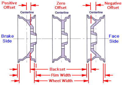

    Yup - a bummer about modern chassis/suspension/steering dynamics. Most modern vehicles have adopted zero or positive offset wheel specifications vs. our old wagons that have negative offset specs.
    Pictured in this diagram...
