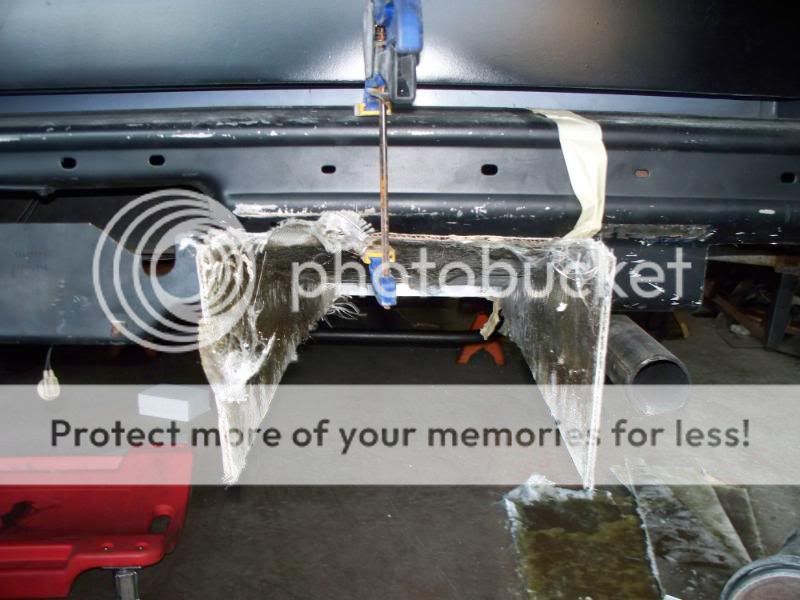

    Now the big question you have to ask yourself is how far do you want to go. Some things are simple and small others are big and complex. Things like lowering your car can actually help your aero because less air going under your car is less air that will be effected by the dirty(aero wise) side of your car. Side skirts(not wheel skirts) can also help. One thing I did was to add a diffuser. Not so much for downforce but to get air out from under the car better. Look under most all our wagons and you will see your fuel tank behind your axle and then a big open area between it and the rear bumper which hangs down like a parachute. The air comes under the tank and then spills into that open area and becomes turbulent(causing drag) and then gets caught by the back of the bumper till is spills out behind your car in one big turbulent mess. All creating drag. So I made a diffuser that took the air coming under the tank and fed it smoothly out the bumper. Have a look.
    Here you can see the before and after of where I cut the bumper.

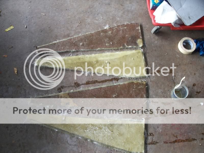

    Templates for the side fences of the diffuser.

    Now at the end of the day the wagon was a lot more stable with no buffeting that it previously had. It was much better with little effort.
