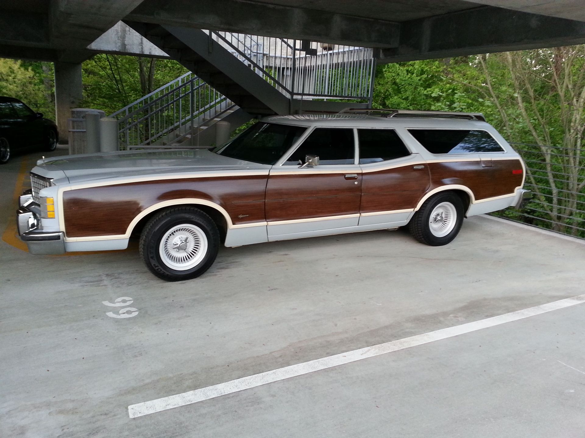

    I like "turbine" style wheels, like your factory wheels. However, if you're going to stick with them, I'd clean them up, like peter stated. I don't think chrome will work well for the look. Turbine wheels are meant to look like aluminum.
    If you like turbines, you could find some wider 15" aftermarket ones and wider tires. They make turbines where there are more spokes, closer together. Or fewer spokes, spaced further apart.
    Here's how my old wagon looked with aftermarket turbines. These turbines have more spokes, spaced closer together.

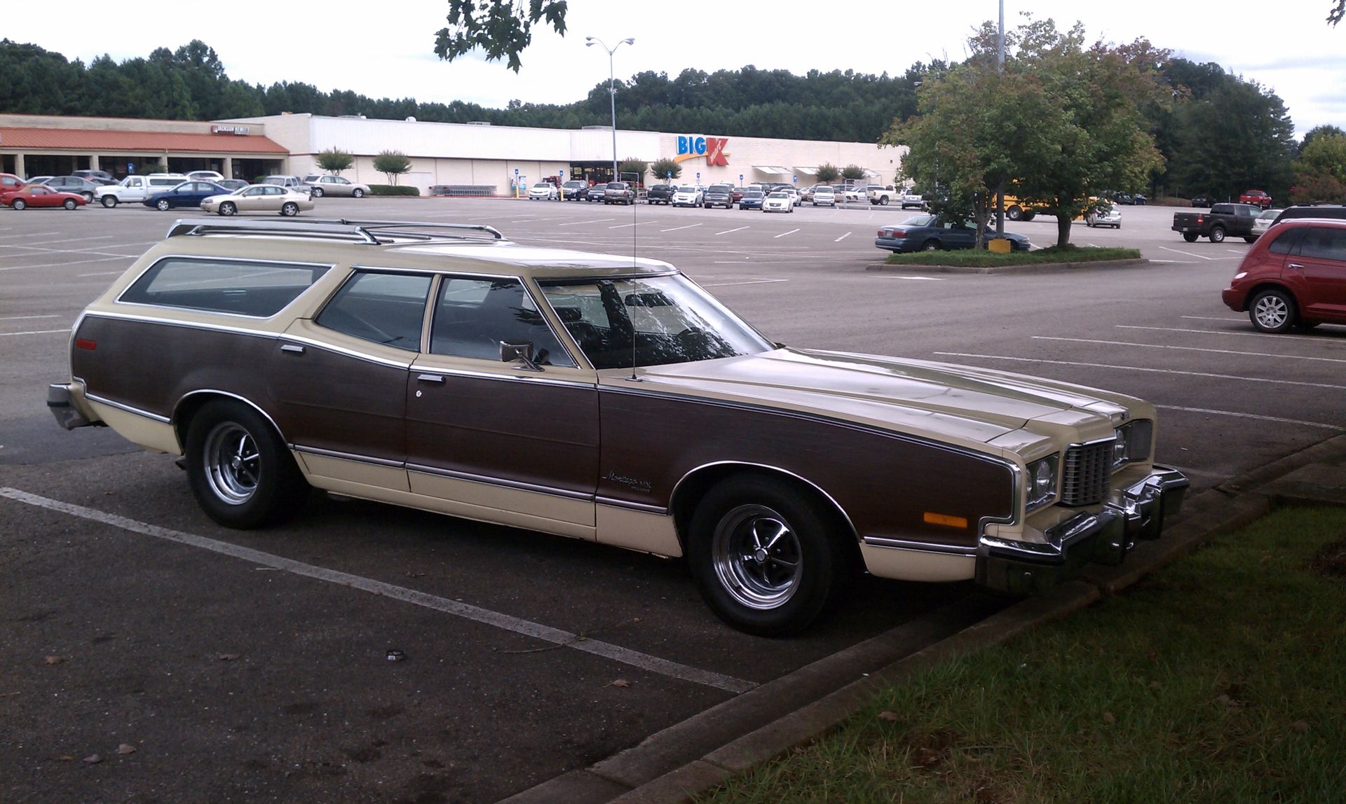

    Or, if you like chrome, you could go with some 15" Magnum 500s, a classic Ford/Mercury wheel. Not too much chrome, and readily available.
    Here's how my Montego wagon looked when I first got it, with some 15" Magnum 500s.
