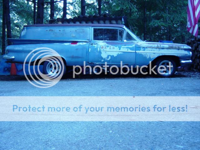

    I have vintage 5 slot aluminum wheels on the rear of my wagon .... it was pretty simple, I set up a lazy susan so I could spin the rim as I sanded using 120 grit ("vintage" means old and crusty!!) and went down to 440 and the final sanding was 600 wet paper and double ought steel wool after that .... then I polished with Simichrome ... that stuff is the best! and after polishing I clear-coated with water-based matte finish in a rattle can ... they turned out really nice but the "touch" that made it all worthwhile was the Simichrome .... give it a shot!!!

  11. wingnut
    wingnut Non-Hockey Fan
    Aug 27, 2011
    385
    Mendocino County, Nor Cal, USA
    are those cougar rims?
  12. wingnut
    Aug 27, 2011
    385
    You can see with the design of the wheel that it was pretty simple to restore ... not a mass of cracks and crevices as yours were ...
    It was probably safe to say that the front of the rim looked like the backs when I first started . They were pretty corroded and scratched and oxidized ... I didnt do anything to the backside other than remove the road grime and grease.
    I also did the front spoked mags at the same time and repainted the spokes ..... the pictures dont do the end result justice though.
