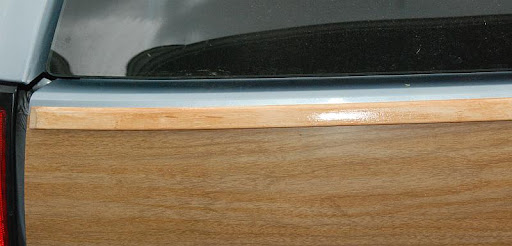

    Refinished woodgrain trim on '94 Roadmaster Estate Wagon

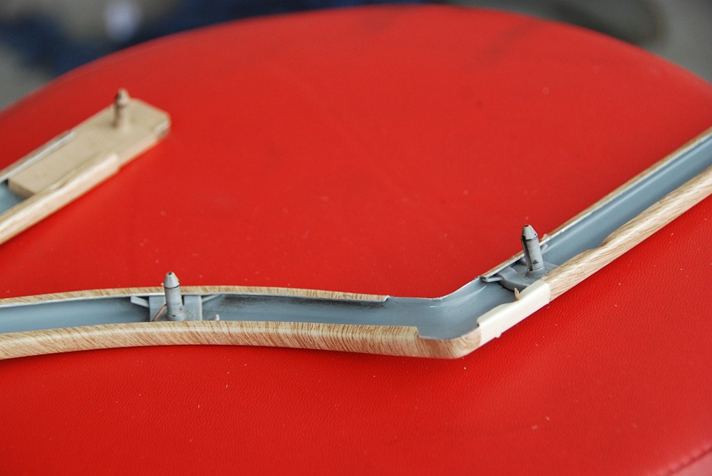

    Having read through Norm's sticky and followed the details over at rickwrench I figured this looked like a fun project. Since this is a long weekend for us Canucks I figured now was a good time.
    I followed everything I had read pretty much to a tee. I went to Home Depot and bought two cans of custom coloured Tremclad (Rustoleum) in #501-Almond and #511-Toffee. I did the car one side at a time to avoid confusion and pulled all of the trim off to get it prepped. After washing the trim with soap and water I peeled off the woodgrain label wherever possible. Several of my trim pieces were still in excellent shape and were difficult to peel. In those cases, I went at them with some 80 grit sandpaper and that took it right off. I cleaned the pieces again and went over them with a 400 grit paper to smooth them out before painting.
    I found a brush kicking around my shop that was pretty old. It was perfect for putting on the Almond base coat and I lightly brushed the paint onto the trim leaving brush strokes in the paint wherever possible and left all of the pieces to try. As the coats were so light, it didn't take long to dry at all. Once it was dry I snagged an old terry washcloth to put the Toffee colour over top. I wrapped the cloth around my finger and dipped it into the paint. It took a little trial and error with the cloth before I was comfortable with it but I found that wiping the paint on with my finger and then lightly spreading it with an unused portion of the cloth worked quite well. After all of those were done and dried I sprayed a clear coat over top of them before reinstalling.
    Over all, I'm really pleased with the results.

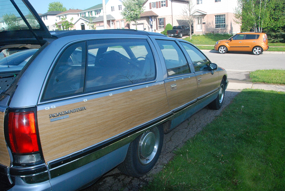

    What's up with the Olds hubcaps on blackwalls in the closer shots and the Raodie alloys with whitewalls in the other shots?
  8. Cyber-Wizard
    Sep 5, 2010
    2,328
    92
    123
    Ontario, Canada
    Ya caught me! Right after I finished the trim installation I pulled off the snows with the Olds wheel discs. It's the last year for those snows and, since I don't plan on letting the Roadie see snow again, I was in no hurry to change them. Hence the late May changeover. Once I had the summers on I had to take more shots with the whitewalls but my best close-up shots were prior to the wheel swap.

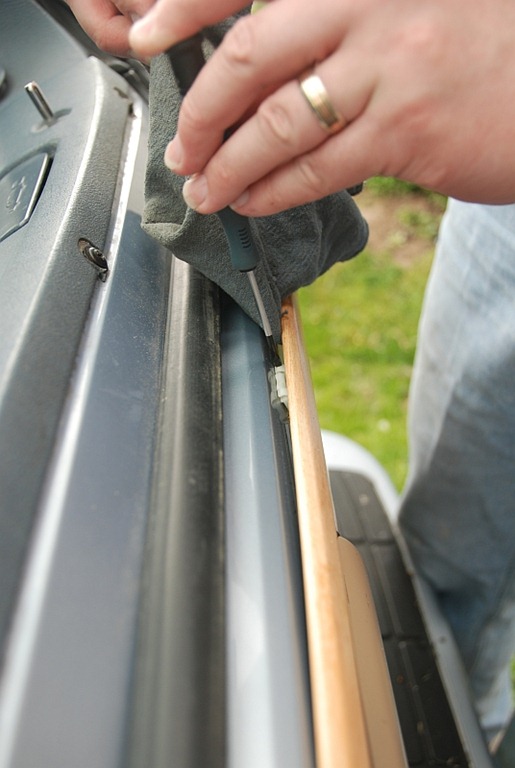

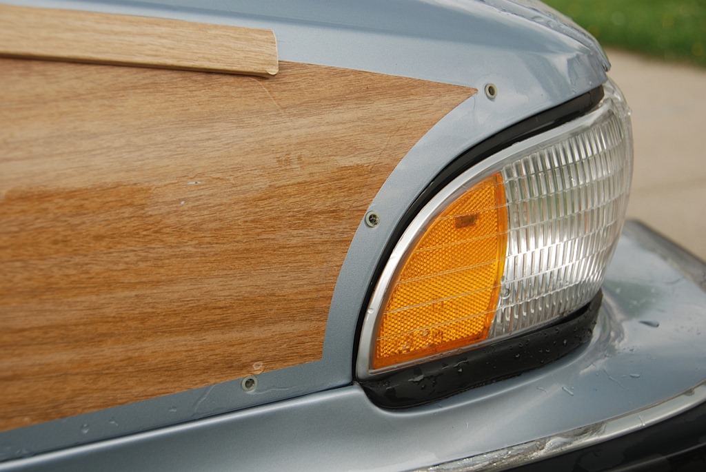

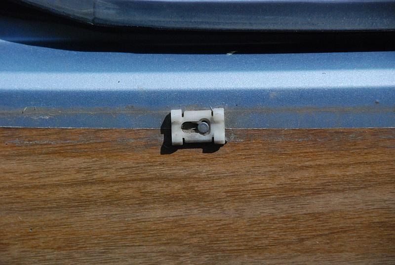

    It's actually surprisingly easy. The trim on the door panels and the tailgate have screws/nuts on them. The trim piece out at the nose has some trim posts that insert into bushings in the metal. Everything else is held on with plain ol trim clips.
    I levered the trim out ever so slightly with a trim removal tool. I wrapped it in a soft cloth and slid it behind the trim until I got to a clip. Each clip has little spring tabs on each side. While pulling the trim out from the body a little bit, I pushed down on the spring tab with a small screwdriver and they popped right off. Putting them back on was just a matter of snapping them in place.
    This is the trim piece that came off of the front fender. it's held on with trim posts that insert into the fender.
