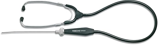

    I use a sort of stethescope intentially manufactured for picking up analog sound. In fact, I bought it in the States and it's a German-made Hazet. Back when I bought it, the $ traded at 1 for 3 German Marks. So, it was dirt cheap, back then. If it doesn't root out the annoying sound, nothing will:

    Was simply talking about what the man may have "on hand". Of course this would be the way to go but I will warn you if you have any ear problems like I do this will NOT go well. I cannot use one of these with my right ear prob and need to use my left.
