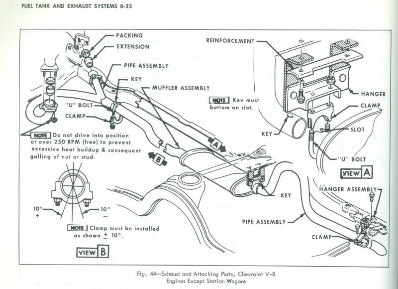

    Wagonkiller is correct. Official docs for 71 Fullsize Chevy. BOP should be same/similar:
    Wagon:
    Wagon and Coupe/Sedan:
    Except wagon:
    Make note of all the stuff that gives spaces, clearances, and how much suspension should droop, etc. Also look at the crimped/flattened portion by the axle. This is where yours in the pics need help.
    Best,
    Tom

    I did forget about the factory slight flattening under the rear. also notice how heavy duty those hangers are in front of and behind the rear.
    I also think running it this way may have been for rear 3rd seat passenger comfort? or fire safety? who knows lol

    I noted looking thru everything in the manual (and some is shown above) that there is only a single exhaust shown for all small block V8 Chevy engine-d full size coupes, sedans, and wagons, but a dual exhaust is only shown for big blockV8 Chevy engine-d full size coupes and sedans, no duals are shown for big block wagons.
    I imagine for a BB dual wagon the straight-back pipes after the muffler would be the same on drivers as passengers side, with a shorter turnout to the left. Back when these were plentiful in the yards I never looked, but I know I have seen 454 equipped wagons, and cannot imagine that these monster motor wagons were single exhaust in 71. By 73-74, maybe...
    And the hangers may have been a little more stout for a wagon, but the illustration looks much like what I have seen on Chevelles and Monte Carlos, which, in good condition, are pretty tough.
    Tom
