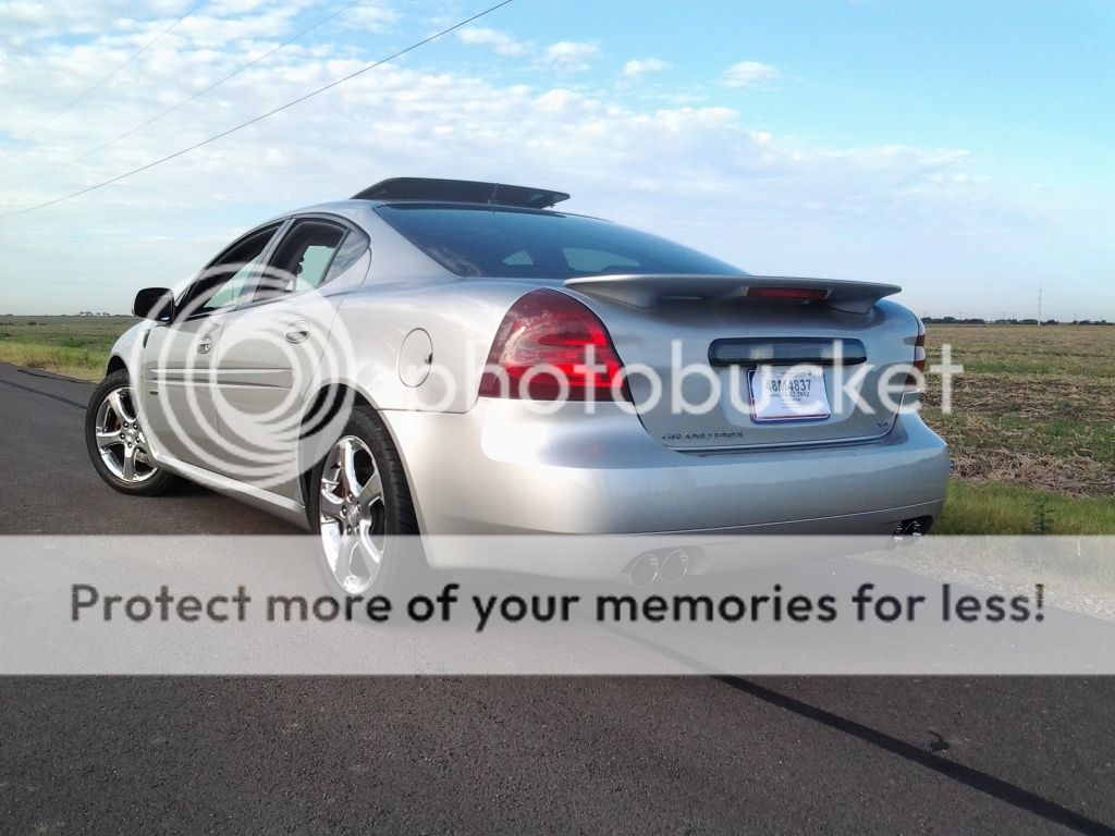

    Is it a Grand Prix GXP? We had one and loved it, 2006 model.

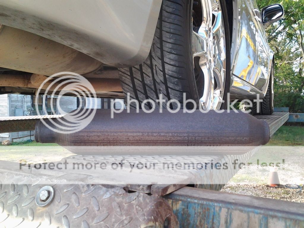

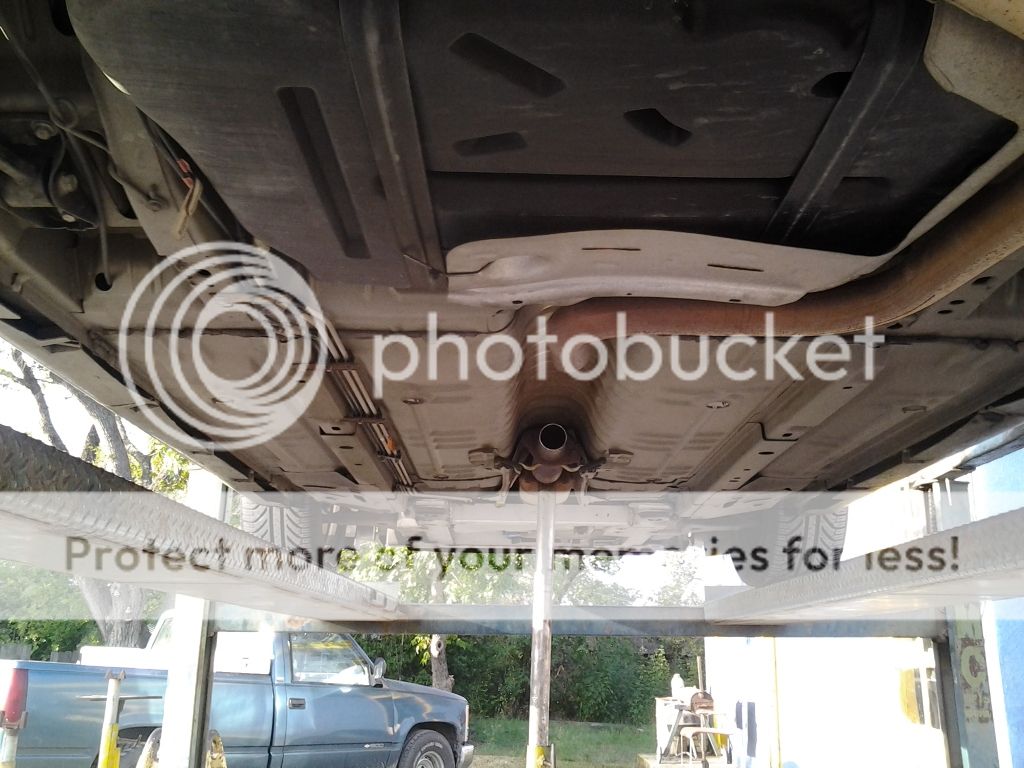

    Oh another neat mod is to remove the resonator. It mounts directly under the interior. Just have it replaced with a straight-pipe. Makes the car sound awesome, but it's still quiet inside. Really makes the exhaust note sound awesome.

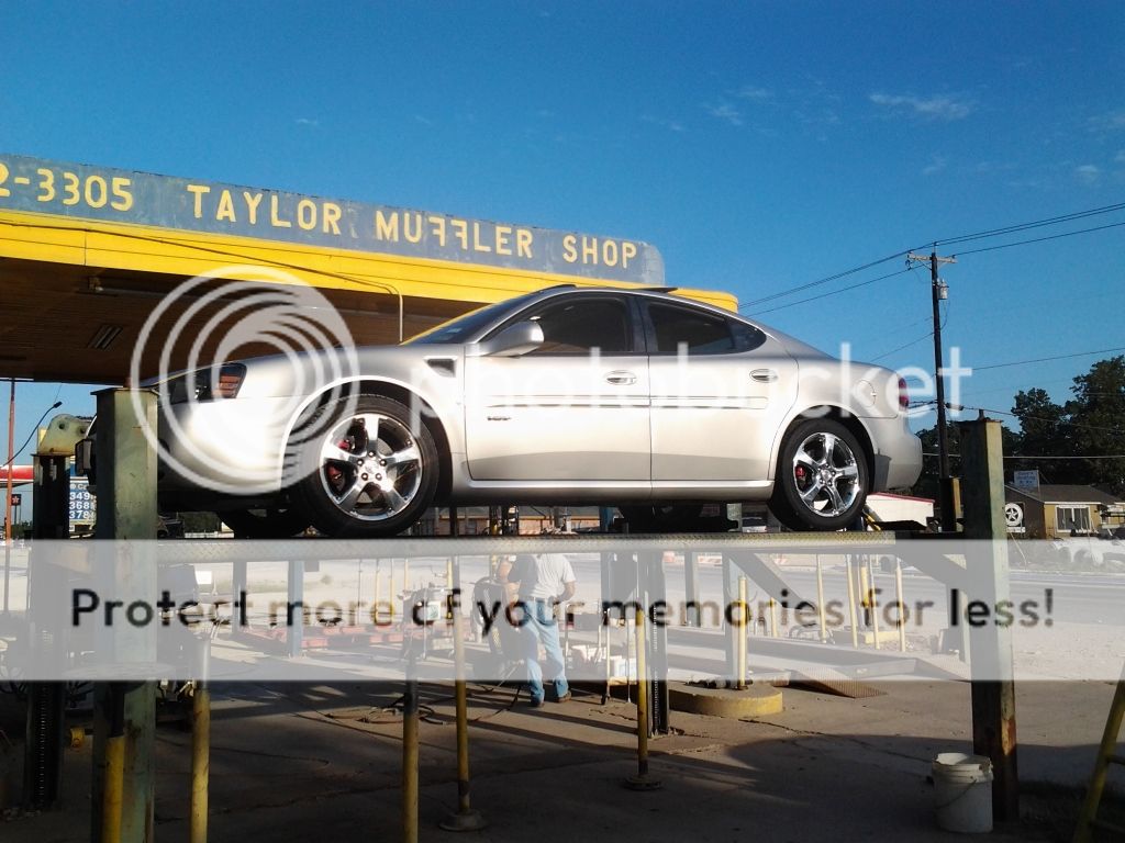

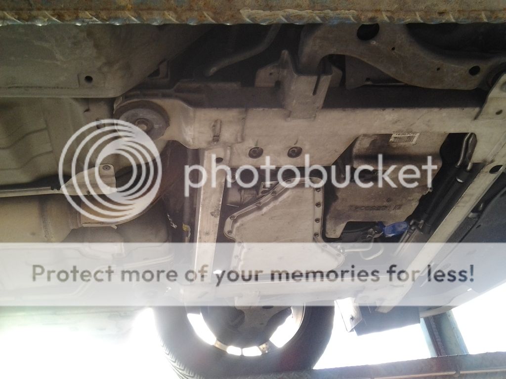

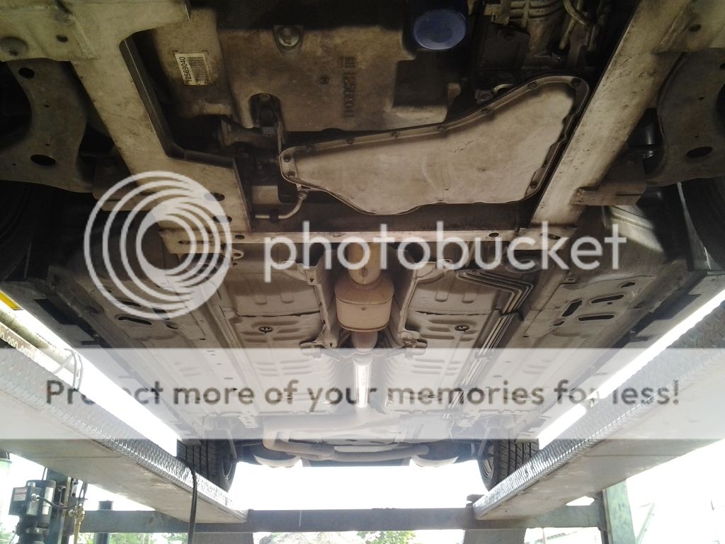

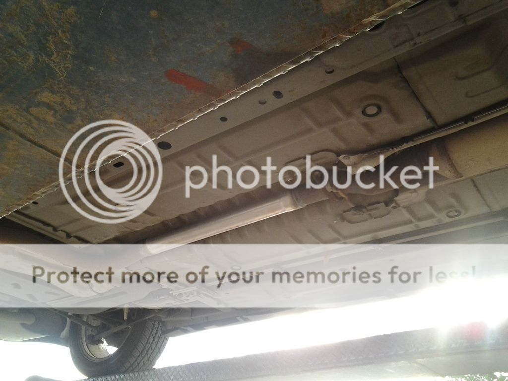

    Here's pics from the muffler shop:
    Resonator removed:

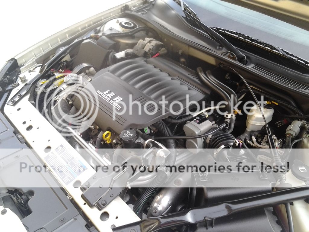

    Heavy-duty subframe for the 5.3 LS4 V8

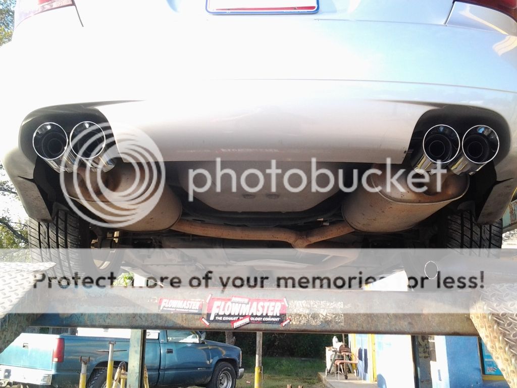

    Pipe welded in place of resonator
    She rumbles now! My 10-year-old Eddie filmed this...hahaha. Click the pic below to hear the exhaust with the resonator removed.

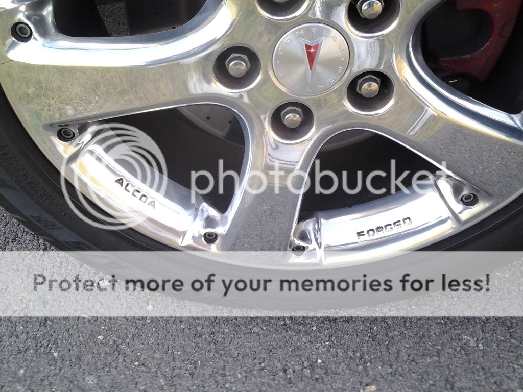

    GXP-exclusive Alcoa wheels. 18x8 in the front, 18x7 in the back. WEIRD!

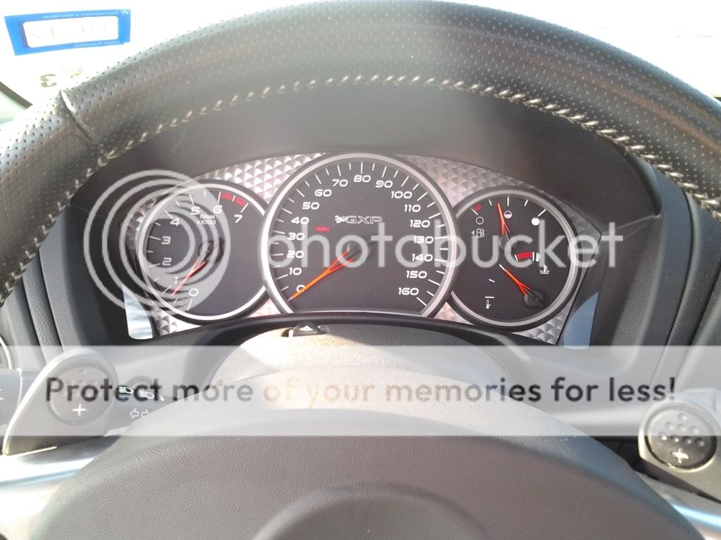

    Heads-up display. Shows speed, turn signals, radio stations, compass, outside temp, and more. Fun gadget
