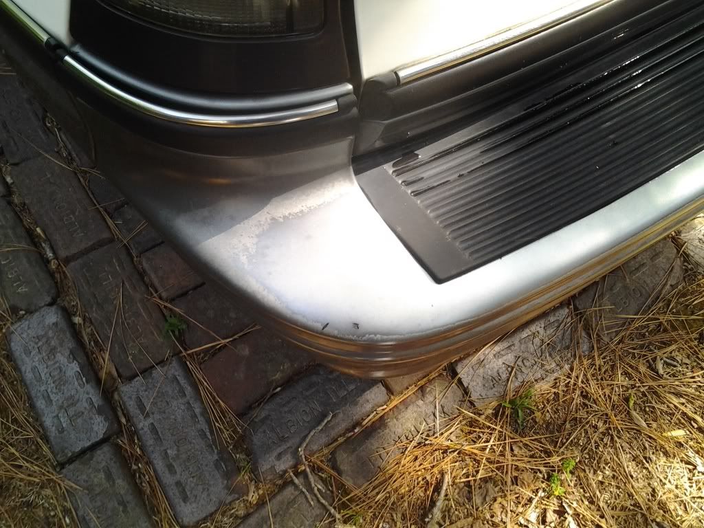

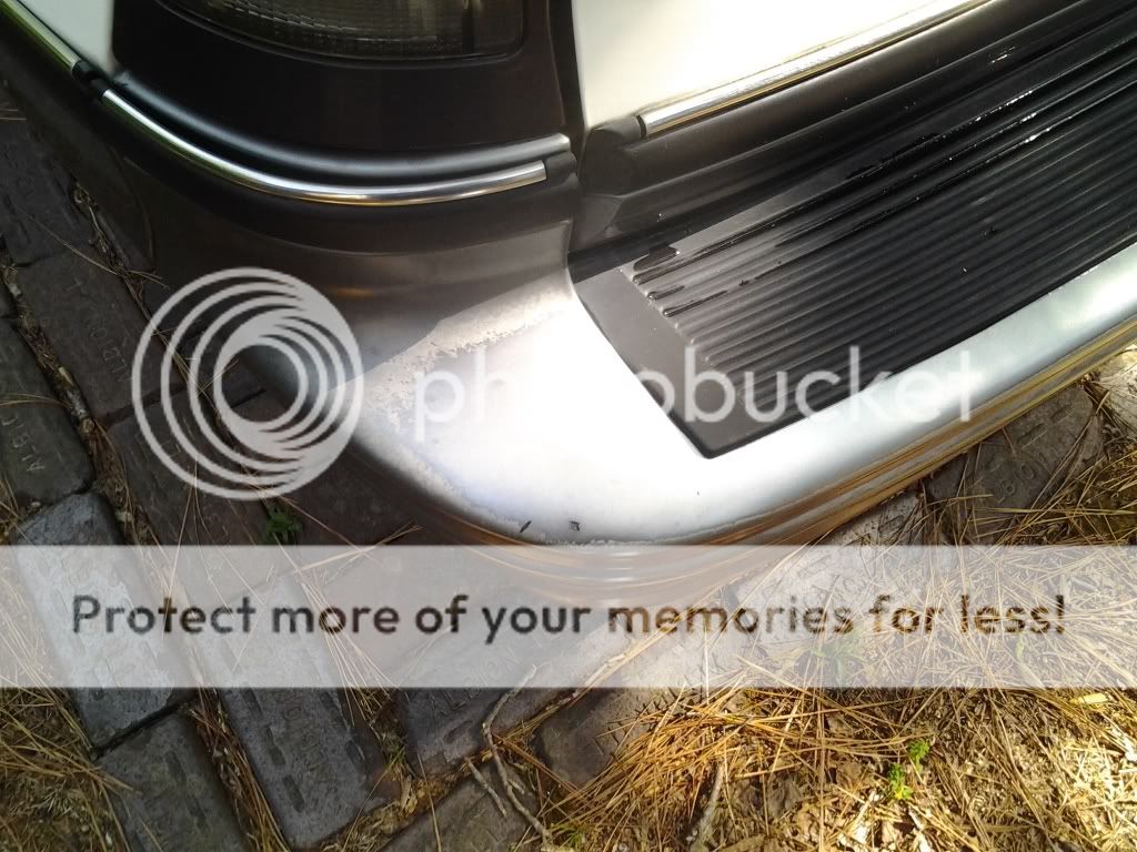

    My next project is getting the rear bumper on the Custom Cruiser re-painted. The car was in a carport in North Carolina most of it's life, and the rear end faced the sunset. The bumper is the only bad paint on the car.
    I drop the car off tomorrow and will get it back tues-wed next week. They are going to sand and paint the rear bumper and the lower rear 1/4 trim, just to make sure the color and gloss match perfectly where they touch each other.

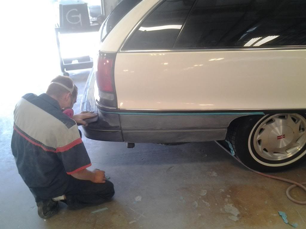

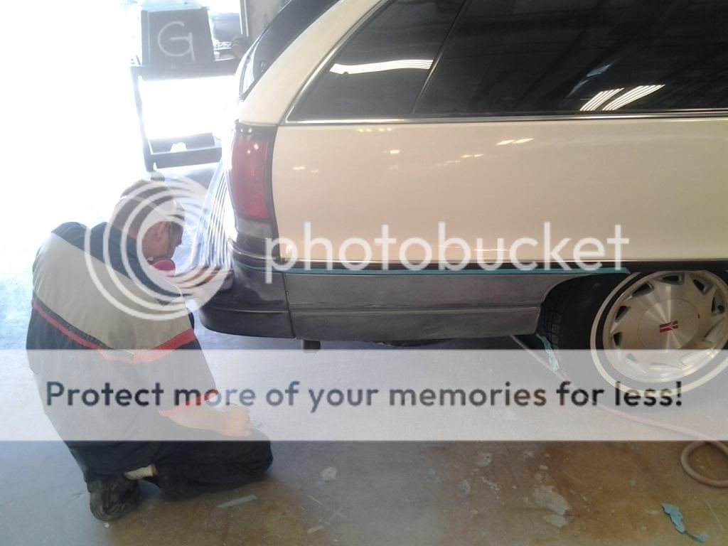

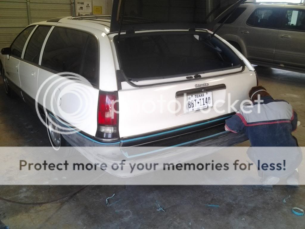

    I was thinking they were going to do the painting without removing the cover, since you mentioned they were going to paint the darker areas on the lower quarters to match as well. Only tough part is for the painter having to paint below his waist. For this job he might even be on his knees...........

    I asked that they not remove the 1/4 trim....hard to find now. May not be as pretty as if they had removed the trim, but did not want to chance anything getting broken.

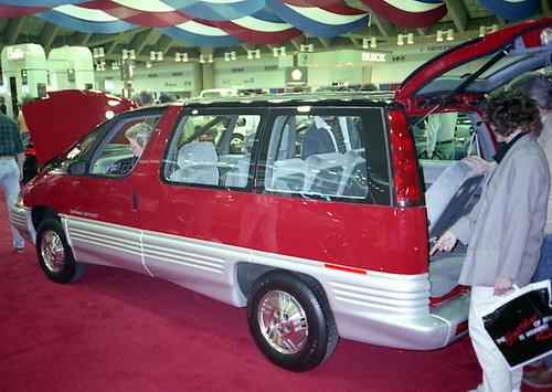

    This is the only reason I don't like aluminum wheels at all. Once the clearcoat on them gets hazy or yellowed (or worse, starts peeling and flaking off) it has to be stripped down, scrubbed and polished, and then resprayed with the clearcoat. Here is an example of a wheel from a minivan I once owned. Example of a clean new van, the van's wheel as crusty as when I got it, and the wheel as best as I could do without stripping/respraying.
    I was able to brighten the wheels but I wouldn't be able to get that shine without going through the whole refinishing process. It was a $250 van, I wasn't about to go through that much effort, but I did scrubby pad it with simple green and polished with a red shop towel and some toothpaste. That's about as good as it gets without acid and aerosol.

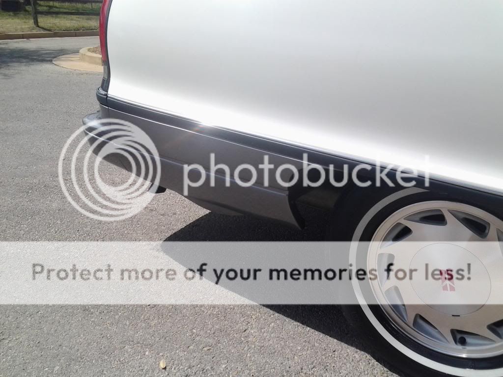

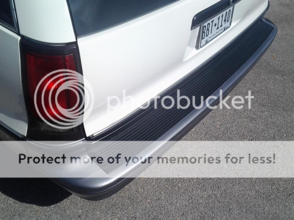

    BEFORE:

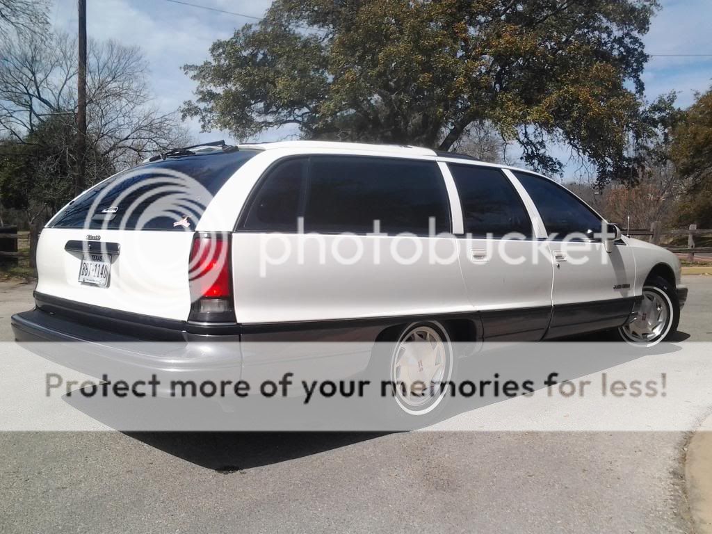

    AND AFTER:
    It's a beautiful day in the neighborhood! :thumbs2:
    -Mike

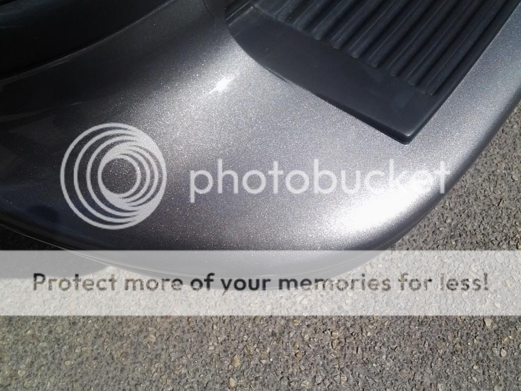

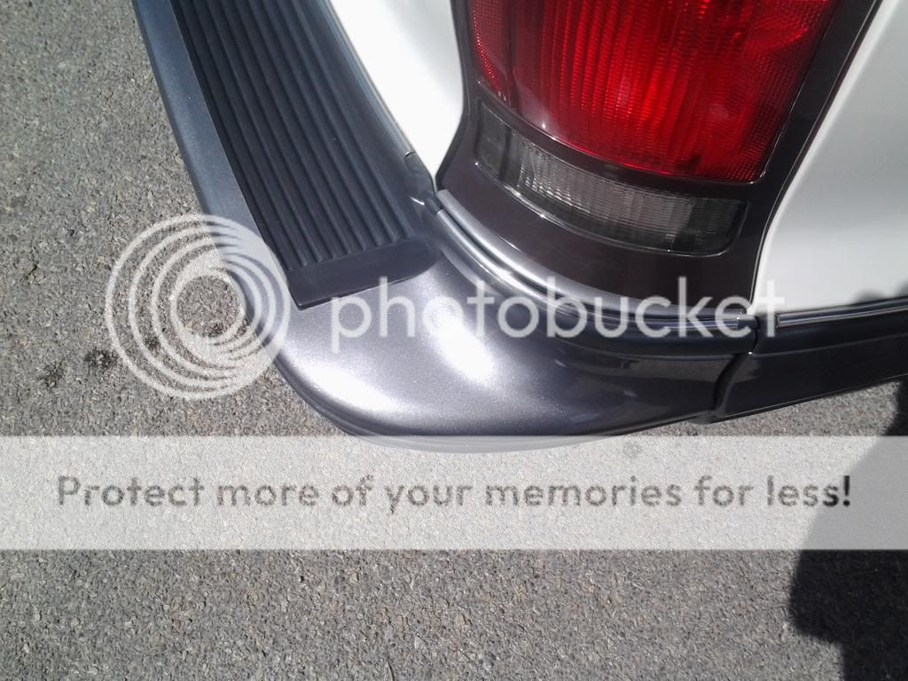

    It's weird paint. Shines and has a lot of sparkle in it, but not a smooth-like-glass finish. We talked about it and he said GM used this paint on a lot of 90's vehicles for the lower body cladding.
    The gloss matches the door and front bumper trim pretty much perfectly. Car looks SOO much better from the back now.
    They did mix flex additive in it, so hopefully the kids climbing in and out won't hurt it. He did say to leave it parked in the sun about a week and also not to wax it for a month. Lifetime warranty against cracking or fading. Works for me!
