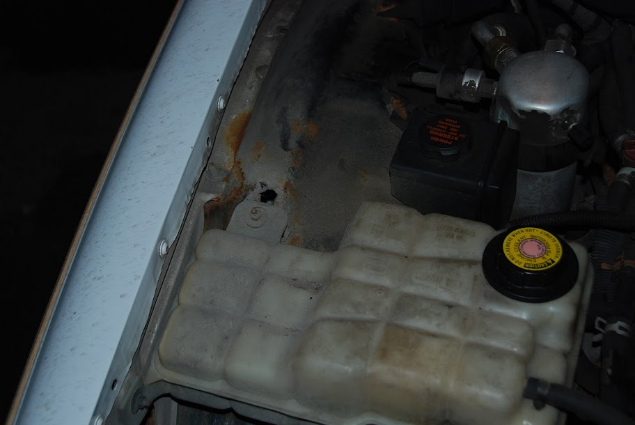

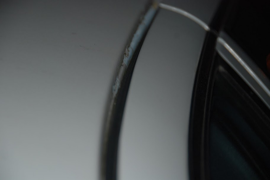

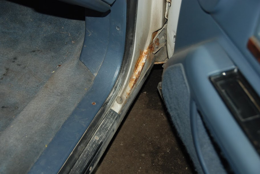

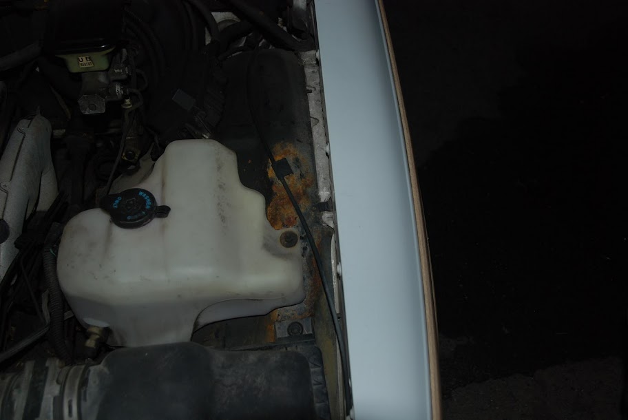

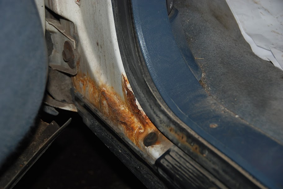

    With getting caught in traffic through Mississauga/Toronto it was almost dark when we got there. I managed to get a few pics of the worst of it. It was too dark in the wheel wells to get the camera focused to show the gaping holes.
    [​IMG][​IMG]
    This peeling paint along the roofline seemed pretty weird to me. It was really dark by then so the pics didn't turn out very well. This is the best example.

    Holy crap! That's a rust bucket, wiz. I don't think that car is even worth $2800 from what I see. Good thing you took a pass on that.

    hey wiz, the pealing paint just screams cheap body repair IMO, and the rust, you would walk outside in a couple of months and look in the drive and find 4 tires and a pile of parts where you parked the night before!!!!!!!I wouldn't give $280 for POS:whew::whew: glad you walked away man that would have been a big mistake!!!!!!!!!!!!

    I wish I could have gotten a photo of the massive hole in the wheel well. That's where the water was getting in to rot out that door sill. It was large enough that you'd have to watch for animals living in the body cavities. :D
    What's really frustrating is that the car looked spectactular from even 10 feet away. It wasn't until you really got up to it that you could see how cancerous it was.
