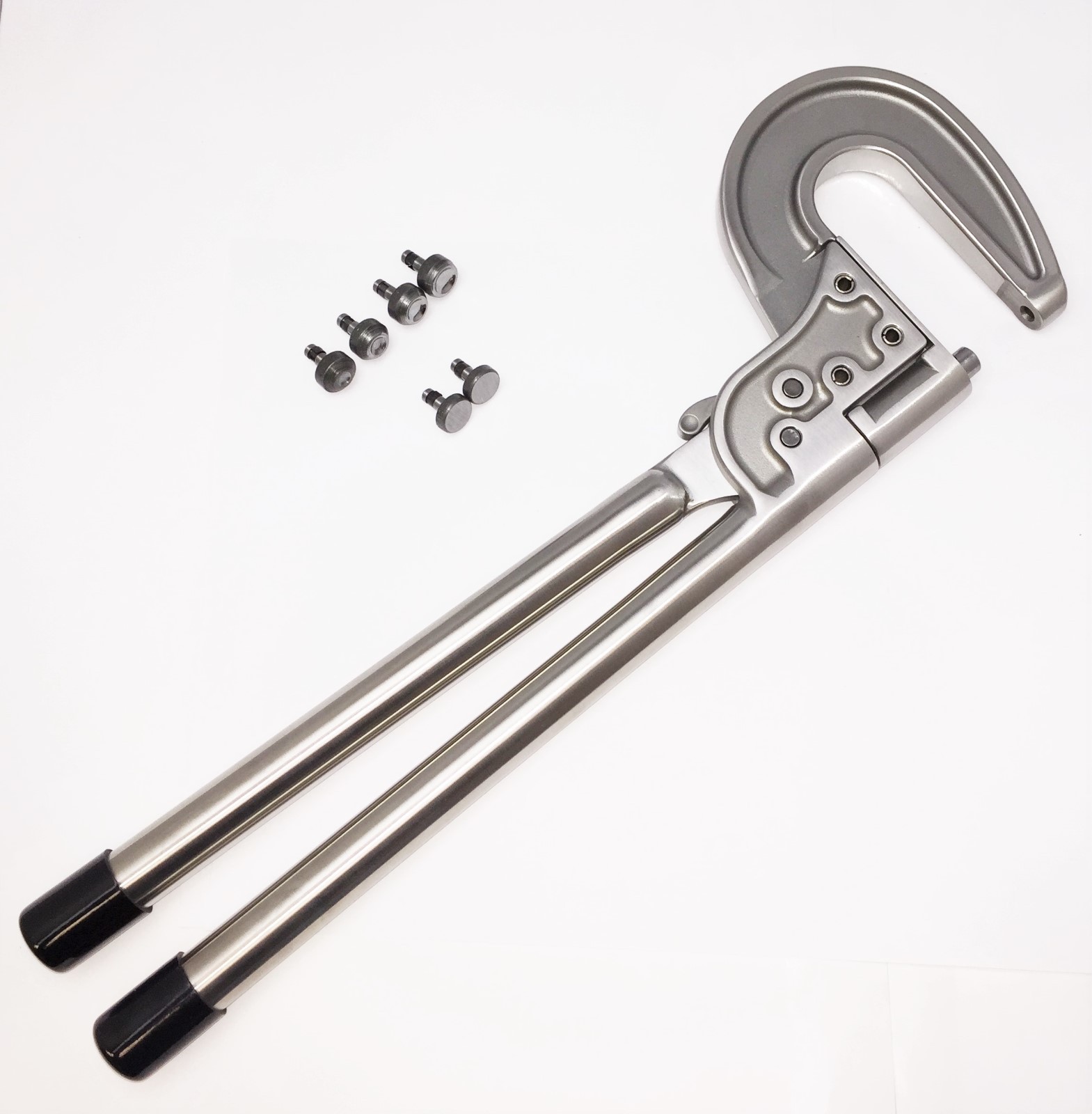

    They would have used a rivet squeezer, but what style I do not know. I don't know what the access around the grill is like. But I would look into using a hand tool that you tap with a hammer while holding a heavy bucking bar on the round head of the rivet.
    I would try it out on something you don't mind damaging until you get the technique right.
    the squeezer would be something like this
    https://www.ebay.com/itm/Hand-Rivet-Squeezer-3-Reach-w-6-Rivet-Sets-New-/280750358896

    That's pretty close to the Kent-Moore tool, but the Kent-Moore one didn't have multiple swapable anvils.
