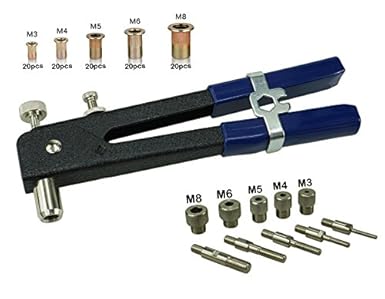

    Been there done that. Leave what has fallen in alone, it will find a spot and get stuck. NO need to remove the headliner.
    Get a threaded insert pop tool, same/easy as a pop rivet gun. before you put the insert in apply a bit of good caulking, I personal;y don't recommend silicone but thats your choice. I'd also recommend doing everyone on the roof, you are there already, rite?

    There is an RV caulk you'd want to use, available at any RV or trailer supply company.
