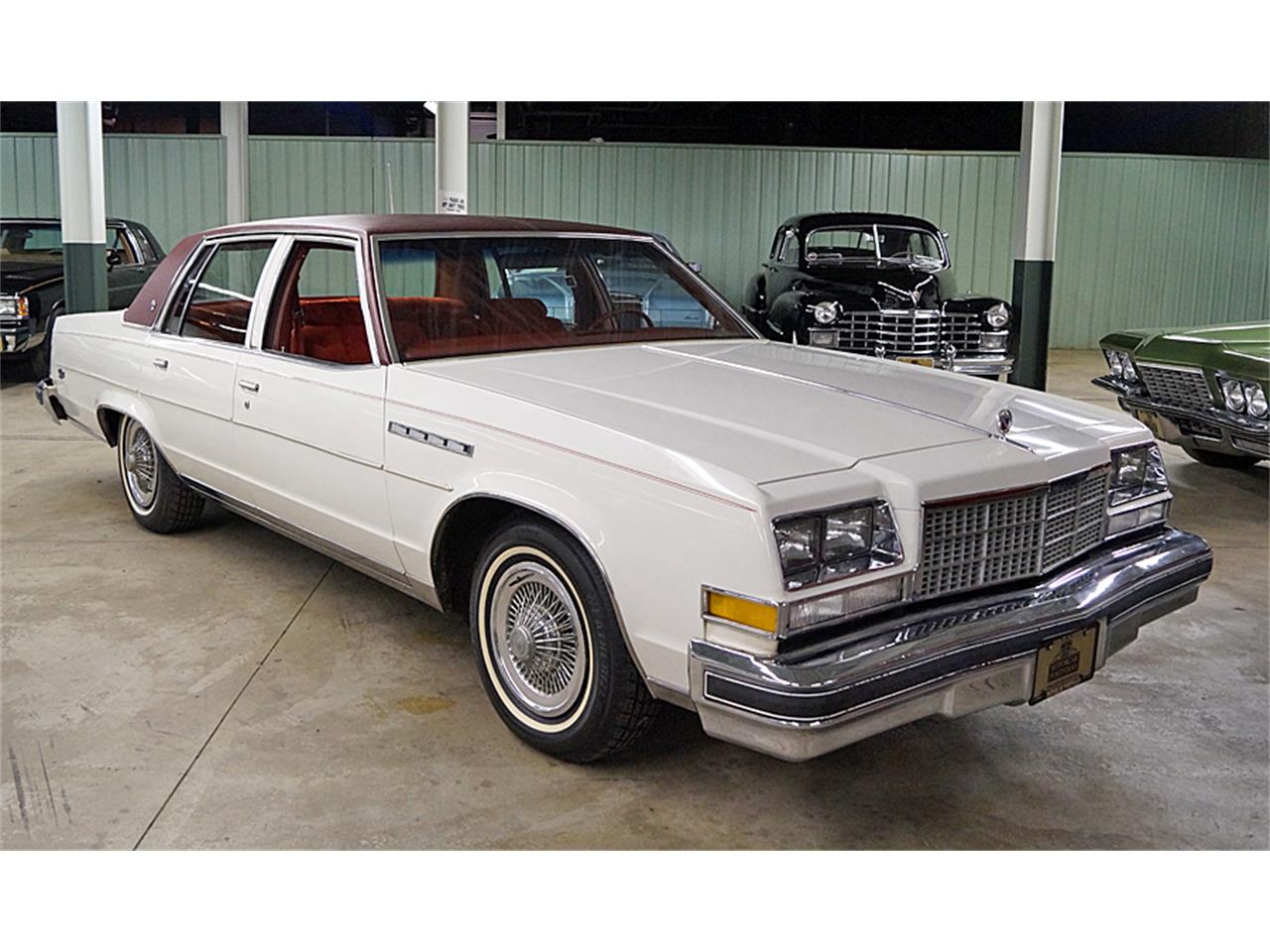

    OK, here are pictures of the wagon we picked up yesterday, a 1977 Ford Estate. The interior is in great condition, just needs a little cleaning and airing out. It has been sitting in a garage for the last 32 years. Last registered in 1987. 87,780 showing on the odometer.
    But as you can see in the pictures the front clip is wrong. Not sure of the back story on this but man it looks strange.. Does anyone know what the fenders and hood may have come off of? Also, the vin number has a R for the engine type but I can't find a vin decoder that shows a R for the engine type. I'm assuming that it's a 350 but does anyone know for sure?

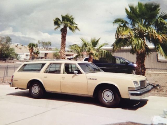

    Here's a 77 Buick like yours with its original matching front end:
    Your car should look more like this. Note that in the pic above, there are fender vents (real or fake, I don't know) but there's no trim underneath them like there is on yours (pictured below) and the metal bends in a different place near the bottom than the fenders on your car. Also note that the bend in the bottom of the fender doesn't match with the door on your car, then of course the fender doesn't fit right.
    It looks to me like someone put a Buick Electra Sedan Front End on your car, likely due to rear-ending another car or (worse) a head on collision; I could be wrong about what kind of front end it has now, though.
    Is the lower dashboard bent, cracked or broken where knees could have bumped it? Maybe the steering wheel isn't original either?

    I think you're probably right about it being a Electra front end. Everything inside the car looks good. I looked at the frame and core support before I bought it and all looks ok. My guess is a crumpled fender and he couldn't find one to match so he bought a whole front clip. Front what I understand the PO was a metallurgist and quite the tinkerer.
