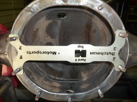

    -The "dogbone" is a tool that shows where the edge of the axles end up when bolted in the housing. It allows measurements to be taken with a bare housing when narrowing a housing.

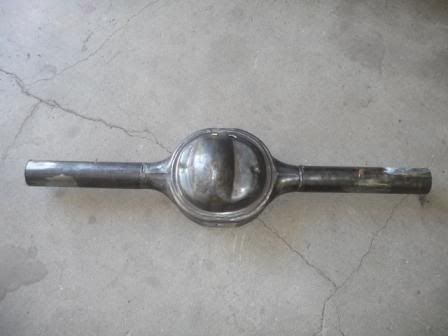

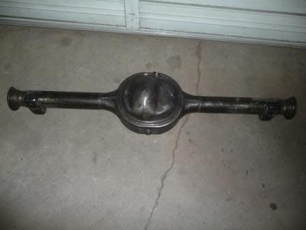

    The rear end housing that I will be using is from a late 60's early 70's Ford pickup. It is the small web housing, but it has 3" O.D. housing tubes that are .188" thick. It will handle lots of abuse:

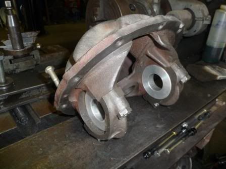

    I will be using the small bearing axle ends from the 8" rear end. They have already been cut off and faced in a lathe to 2 3/8" in length:

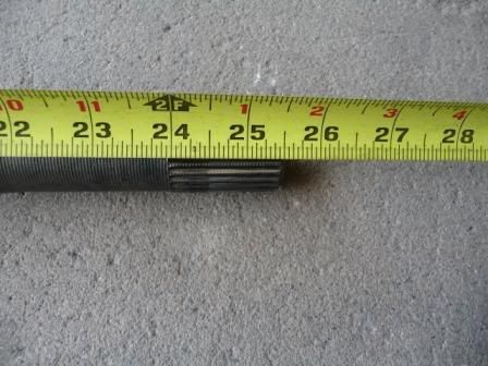

    The left side axle measures 25 5/8" from the outside of the flange to the end of the splines:
    The right side axle measures 29 5/8" from the outside of the flange to the end of the splines:
    Here is the housing after all the brackets were cut off and ground smooth. It has been cleaned with a stiff wire wheel:

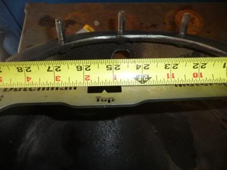

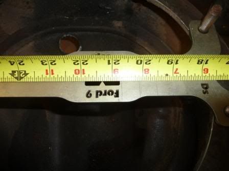

    The "dogbone" is placed on the housing studs for measurement:

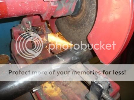

    -Now for some math to determine where to cut the housing:
    -29 5/8" right side axle length minus the 2 1/2" brake offset minus the 2 3/8" length of the housing end = a 24 3/4" housing cut measurement.

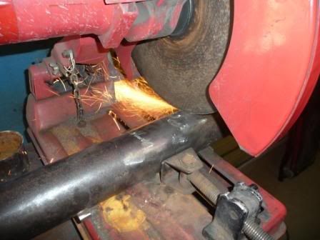

    So we set the housing on the chop saw table and we measure from the edge of the cut off wheel to the right side of the dogbone:
    ......and the end of the housing is cut:
    -Now for some math for the left side:
    25 5/8" left side axle length minus the 2 1/2" brake offset minus the 2 3/8" length of the housing end = a 20 3/4" housing cut measurement.
    The housing is set on the chop saw table and we measure from the edge of the cut off wheel to the left side of the dogbone:
    ....and the housing is cut:

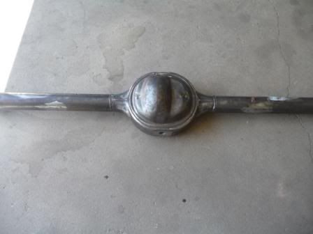

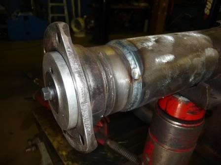

    We now have a very narrow housing waiting for some housing ends to be welded on:

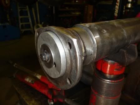

    A dummy centersection is set up with aluminum mandrels in place of the bearings:

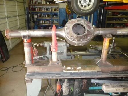

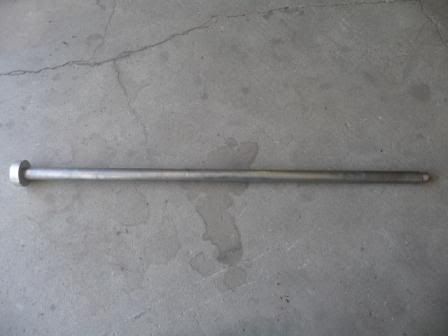

    This is the 1 1/2" diameter stainless steel alignment bar that will slide into the centersection:
    The centersection is bolted into the housing and the alignment bar is slid in place:
    Another aluminum mandrel is used to place the housing end on the alignment bar. The face of the centersection is leveled and the bolt holes on the housing ends are also leveled. The housing end is tack welded in four places 90 degrees apart and then fully welded:
    Here is the finished housing. When assembled, it will measure 56 3/8" wide, narrower than any 9" ever offered from the factory:
