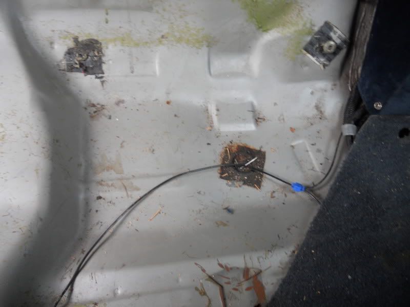

    Ok so i tore out the back of the car. unfortunately i didnt have a camera when i was doing it so these are photos of the aftermath:
    [​IMG]^ the wooden floor has all the crap i ripped out on it but this is about where it came to.
    [​IMG]^this is with the floor pulled back, again the area under it was a cargo space for the spare and jack..or bag full of Halloween props.
    [​IMG] ^taken from the front seat looking back. there are 2 bolts on either side and what looks like a bracket that was cut off ( one on either side )
    [​IMG]^drivers side rear area
    [​IMG]^close up of what im guessing was a bracket the front of the seats went in.
    Does any of this help?
    i cant find any information on how to install or remove a folding rear seat in this car or one like it, not even a picture on what one looks like.
  13. Krash Kadillak
    20,894
    1,971
    If you've got brackets that were removed, then you may have to get some out of a wreck. Find one at your local Pick-A-Part, take some placement measurements, unless the mounting position is obvious with a depression or something. If they're spot-welded on, a cold chisel and a big hammer should make fairly easy work of them. Maybe a drill to drill out the wlds a bit......

    Should be going up to the junk yard tomorrow or wednesday to find a seat. ill see if they have some brackets laying around, if not it doesnt seem like it would be hard to fab something up..
