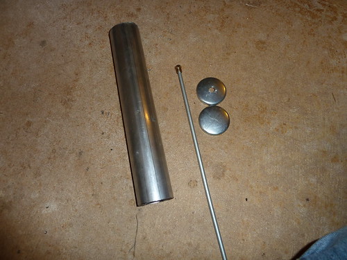

    My '68 Ford didn't originally have a coolant overflow bottle. I wanted to add one that would siphon back into the radiator on cool down. Space is at a premium under hood due to some other mods I have planned, so I decided to build one myself that takes up very little room.
    This is what I started with. 2-1/2 inch exhaust tubing, 2 freeze plugs, and a stick of 5/16 brake line.
    [​IMG][​IMG][​IMG][​IMG]

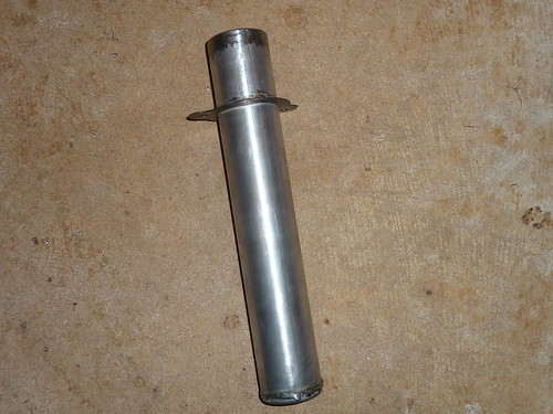

    I tapped one of the plugs, cut the brake line and flipped the nut around backwards

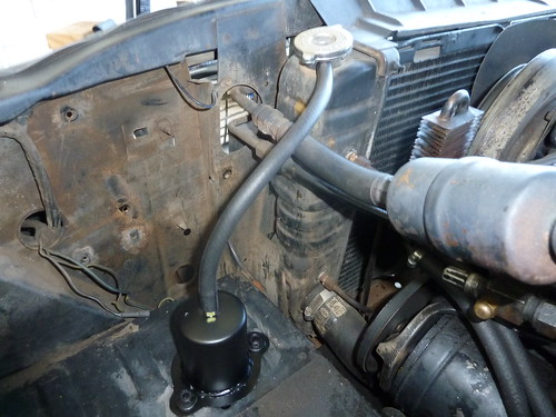

    Then I relocated the horns and cut a hole in the inner fender. Uses the factory threaded inserts for the horns
    Laid out pattern on 16ga steel & cut it out
    Had a buddy weld it for me
    Painted and installed
