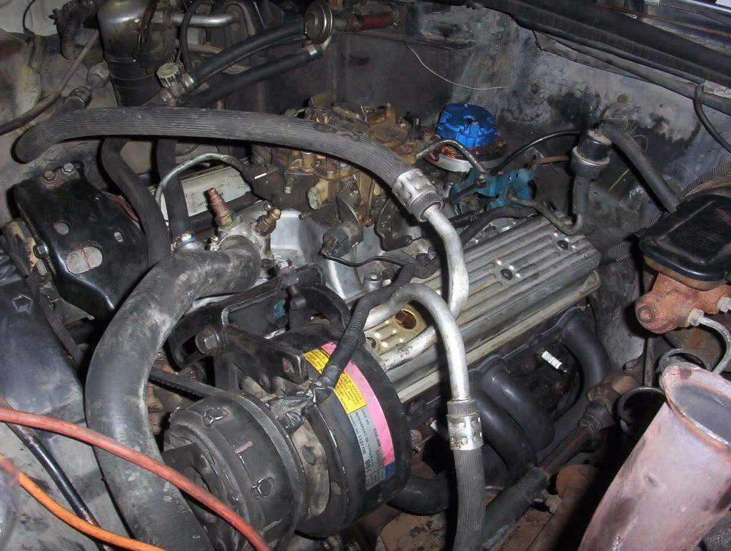

    I got my exhaust done tonight, and should be firing it soon. I won't be doing much tomorrow night, CSI is on so I won't be working on the car :lol: I used the stock Y pipe for the most part, and just tied it in to the stock pipe. Eventually I'll be redoing it with 2.5" all the way back, but for now what I have is fine. Here's some pix

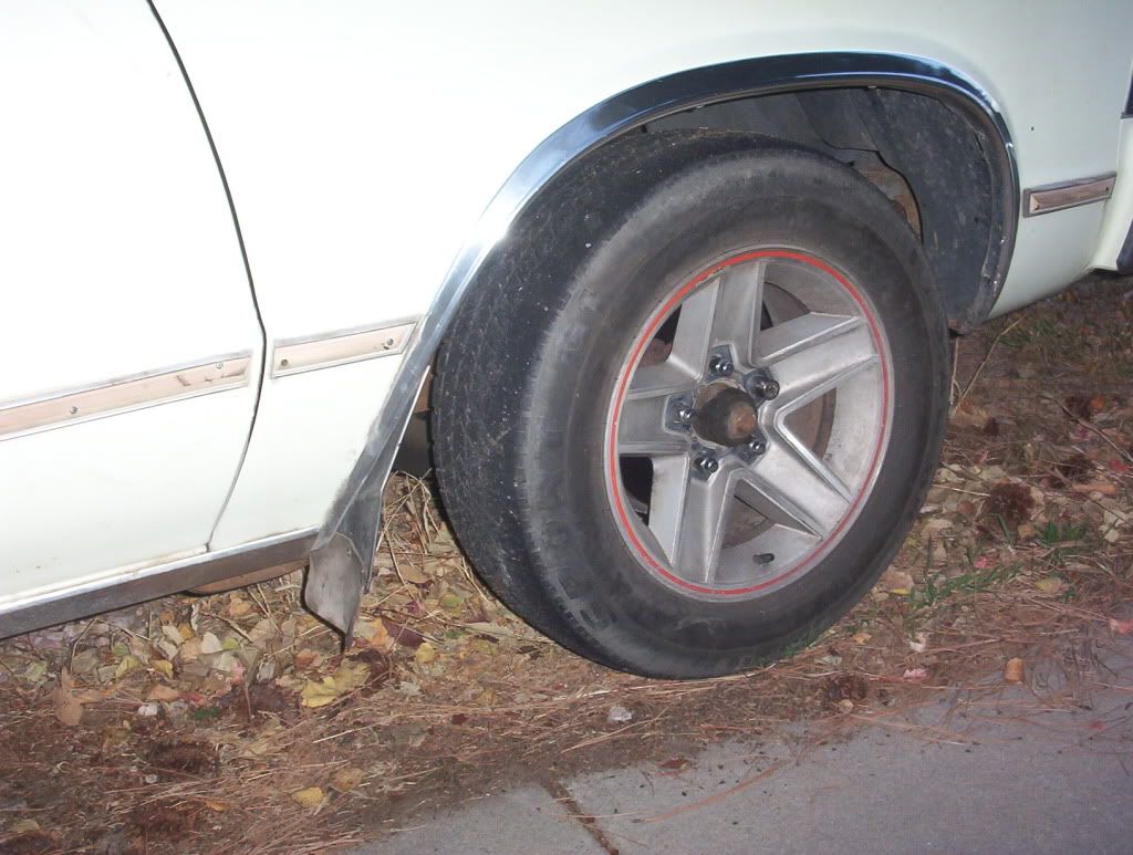

    Just thought I would come back with an up date. I took the wheels off my 79, and put them on the 81 today. I had some 1/8" spacers that were on the camaro, so I put them on the front. The camaro wheels hit the A arm a little bit, and it ether knocks the wheel weight off, or scrapes half of it off. Other then that they look ok, but I could do with out the red line. I will eventually be cleaning them up and painting them black to match the car when I paint it. That is if I decide not to use other wheels before that happens. I also got the trim off, I wish I could get ahold of the guy that screwed it on, there's holes in my body for no reason! [-X I also found out that I NEED more power! :lol: The 305 does alright, but it bogs down when the car starts to move after the tires stop spinning! :lol: Of course part of that is still the carb Im sure. I have no idea what Im gonna do with that, only carbs I have found are 650+. I could never afford a new one, so it has to be used. I'll be replacing my shocks, and an idler arm tomorrow, I didn't have time to get to it today with all the other stuff I had to do. Any way, here's some pix!

    looks good...congrats on the mod...great close up of the screws..DA!
