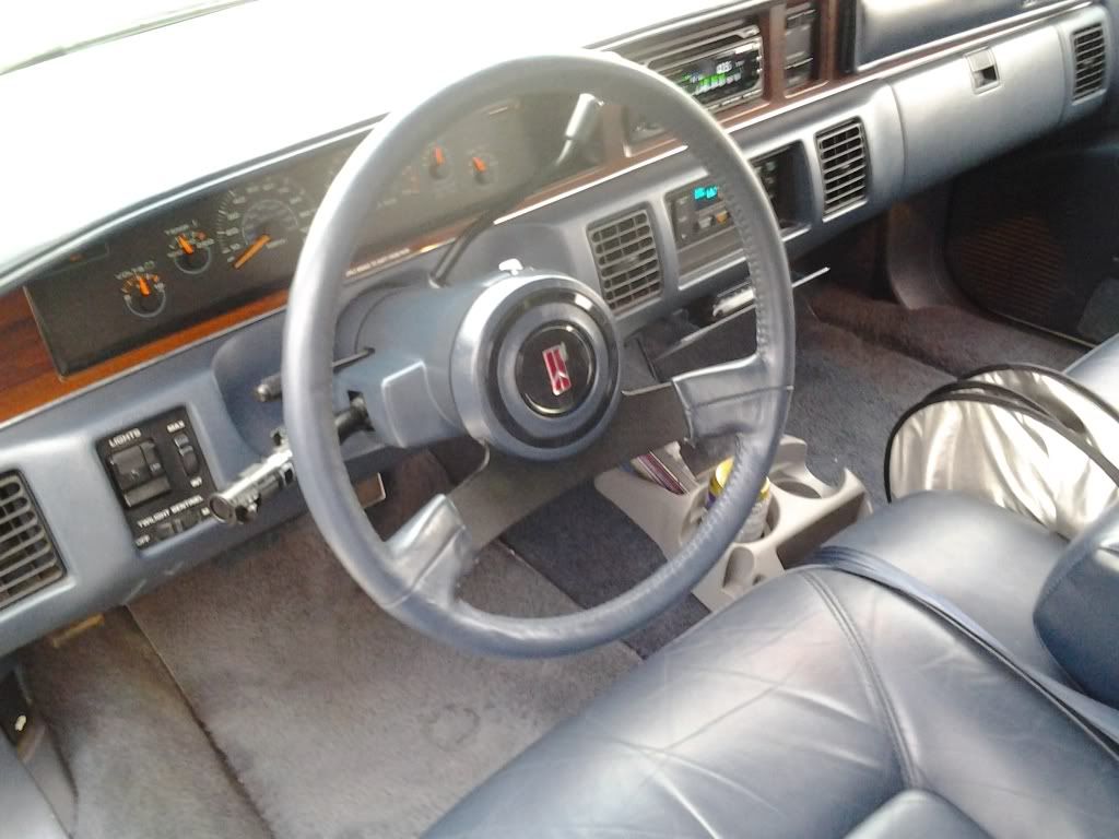

    Got a neat new toy off Ebay. Won't be here for a while, but hope it looks as good as it does in the pics.
    Will be going from this:
    To this:
    I had this same style wheel on my '89 Custom Cruiser, and have this one's twin on my '88 Cutlass.
    Really like these. The leather is thicker and softer than on the air bag wheel, and with the large red Olds emblem these look nice. I'm looking forward to seeing how it looks in the "new" OCC.
    This wheel is coming from California. He says the blue leather is like new and it came off a low-mile car. Hope it really is. Can't wait to get the airbag wheel off and see this on my wagon. :D

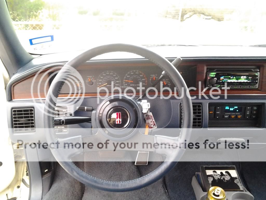

    Before:
    And After:
    Best Mod Yet! Looks and FEELS so much better than that airbag wheel. For a 25-year-old wheel the leather on this one is in very nice shape. Only found one little scratch in it. Got out the saddle soap and cleaned it really well. Love it!
    Love this old car too. :) It feels more like and Oldsmobile now. Hahaha!

    For you OCC guys who want to try this mod, I removed the air bag light from the gauge cluster and just snipped the air bag wire that came out of the column. Taped it off and DONE.
    The 2-spoke steering wheel and horn contact fit the column fine, but when fully tightened the outer ring of the new wheel rubbed the column just a bit, so I used my bench grinder and CAREFULLY sanded it down just a tiny bit. That did it!
    Works fine and look totally factory stock.
    If you're looking, this was the optional wheel for cars with the FE3 handling package. Used in everything from Calis to Cieras, 98 Touring Sedan and Cutlass and 442. Optional from 1985-1990 on most Olds cars. This wheel also was offered from around 82-84 in a half-leather, half plastic style with asmaller horn button...as seen in Hurst/Olds...but I think those look goofy. Go for the full leather ones!
    Oh and the leather on these us MUCH better quality than what was used in the 90's. The color does not wear off, and it's a thicker and softer leather, but like all leather if exposed to the sun for years it will go bad, and these are getting harder to find now.
    My favorite mod yet on this car!

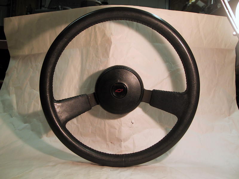

    This is simply the most awesome of all the things. I want one of these wheels for my next vehicle. Or the Chevy version from the late 80s Celebrity Eurosports:
    I also like the base 2-spoke wheel on 90-94 Luminas and the deluxe 2-spoke wheel on 88-90 Beretta and Corsica. Either would work well on an A-body car. They'll fit others but are a bit smaller than a B-body wheel I think.
