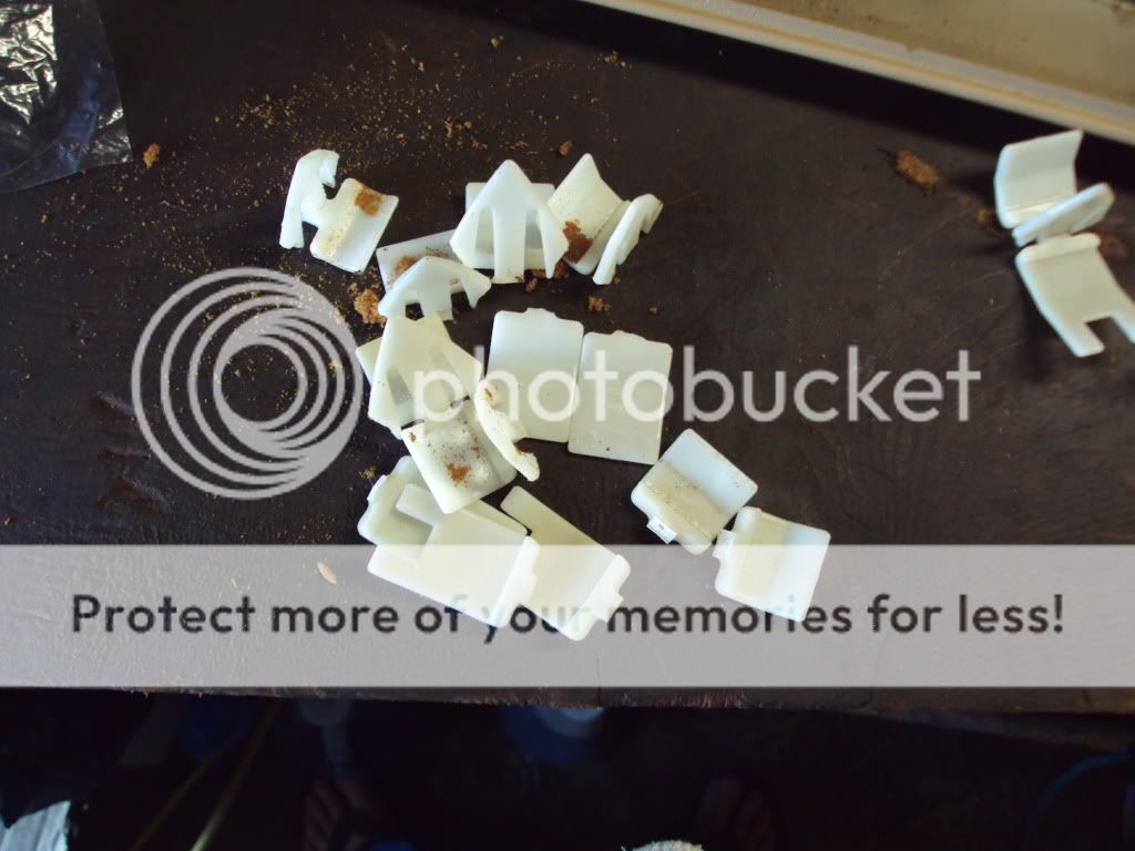

    [​IMG] I'm guessing your old ones all look like this. It is virtually impossible to get the garnish molding off without breaking the clips. Note the unbroken one on the upper right.

    Those are for the rear headliner sides and rear garnish moulding, and I actually found someone who had em and bought all of em haha...But the front headliner I would think is the same as any other B-body sedan. The wagon has 2 headliners as we all know and the front section I thought was a standard thing. The side clips for the front headliner garnish are not like the rear ones are they?
    Just wanna be sure we are on the same page, im good on the rear section with the unobtanium clips. The front headliner side garnish mouldings, above the B-pillars, thats what im lookin for...Ive got the windshield garnish moulding clips

    Yes, you are correct. I was referring to the load-area garnish molding clips. The front garnish molding clips are the same as for the sedans.

    Right, those are for the load area, but im talkin about the front area, those in the pic look like the rear clips, i need the fronts
