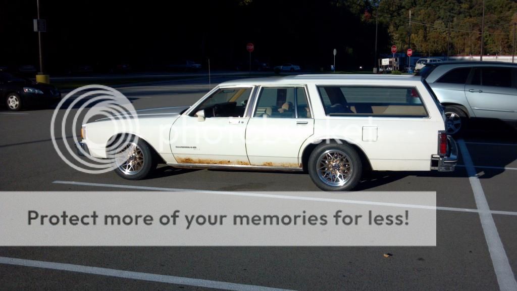

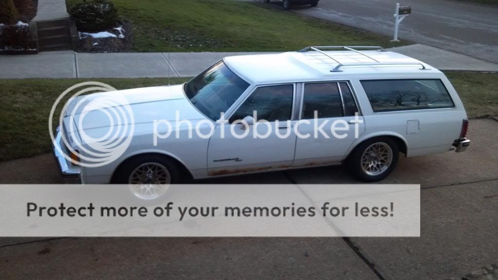

    Here is my current project: It's an '86 Pontiac Parisienne Safari. Pretty base model and utilitarian, which is how I like 'em. I changed the bolt pattern from 5x5 to 5x4.75, (using f-body 1LE rotors, custom axles, and drums from a '77 a-body buick wagon) to allow me to run Year One 17x9" snowflakes. I'm running Hotchkis springs designed for a 94-96 Impala SS, and I am in the middle of swapping in a 55K mile LT1/4L60E from a '96 SS.
    The rust is all superficial from dirt road driving and rocks chipping the paint. The car has only 86k original miles and spent most of it's life in Arkansas. I picked up the roof rack for it from an '89 Caprice destined for the scrapper. I am still open for opinions on that one. It's not actually mounted on the car yet...

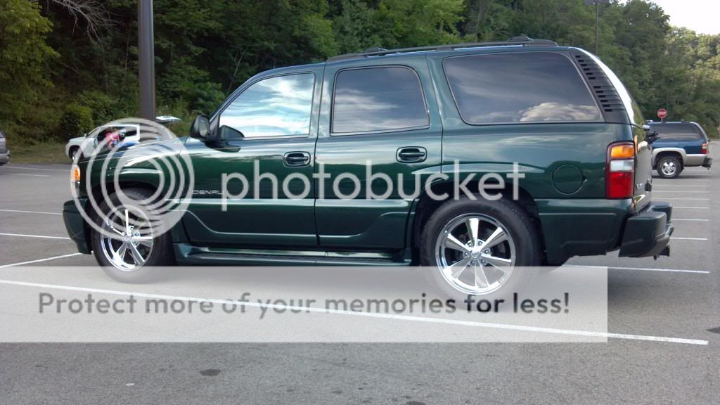

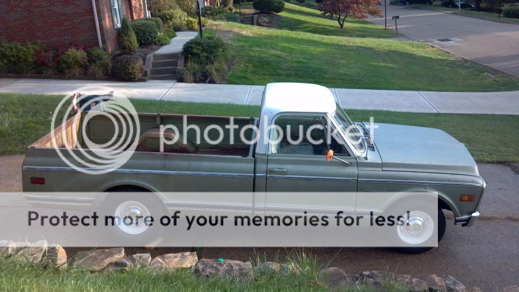

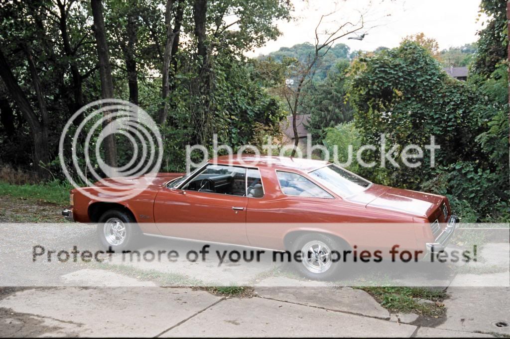

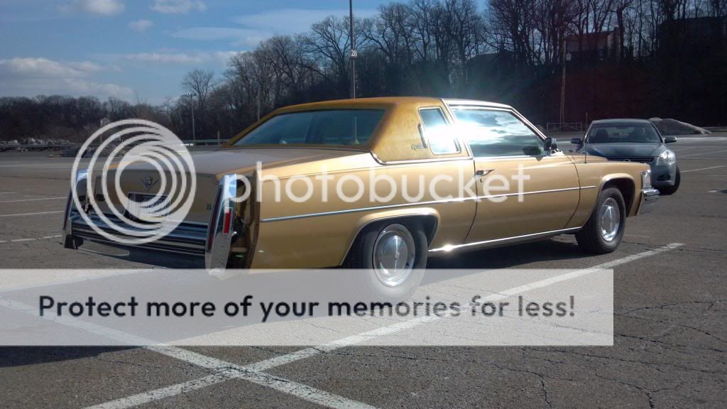

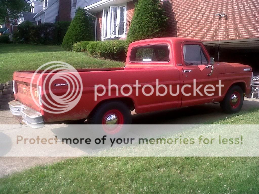

    So, here are the other vehicles/projects in my fleet. The '75 Catalina has been without an engine for some time now, as I've been slowly building a Cadillac 500 to go in it. The '69 C10 is going through a frame-off right now. The '95 Caprice is a civilian LT1 car with the tow package. That's my fair weather daily driver. The '78 Caddy is my winter ride. The '02 Yukon Denali is my girlfriend's daily with a mild drop and some 20" Cragars and 6.0 LS pahr. And the '67 Ford... well it's a ford. I got it on a trade deal and swapped out the tired 352/3 speed for a 390, 4v with long tube headers and an NP435 granny 4 speed. I'll be unloading that one soon- as soon as I get the drive shaft done.

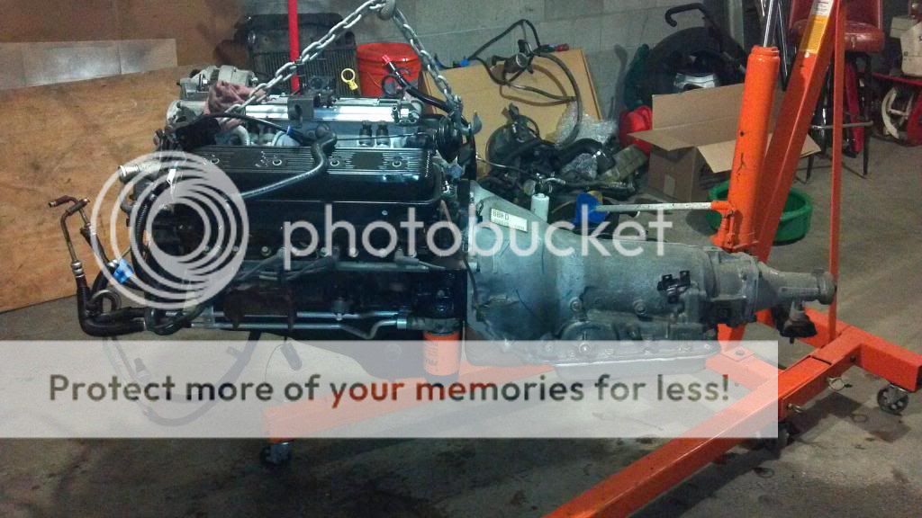

    And this is the 406 small block I built for that truck. All new rotating assembly, Dart 200 cc Iron Eagle heads, Lunati Voodoo series hyd flat tappet cam, Comp 1.5 rockers, blah, blah, blah... The only part that isn't brand new is the block, and that's been reconditioned, obv...
