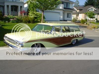

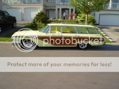

    a pal of mine did a Mondo Moola resto on a 62 Merc Colony park!!
    and ended up doing all the 'side' woodgrain in Airbrush!!
    as well as the Air cleaner top...the door sills ...and more!
    Its a freekin beauty!...I guess it all depends on the "talent" of the guy with the Airbrush:yup:

    That is precisely what I want to do, and duplicate the original look, at the same time!
    What a gorgeous job!(y)
