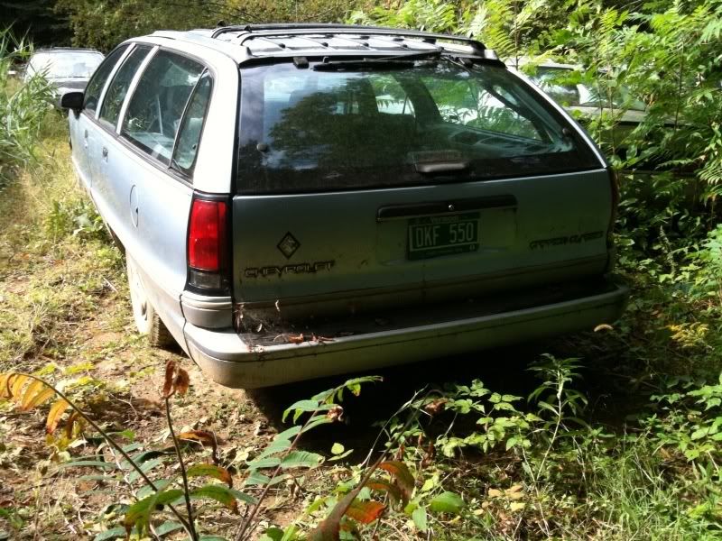

    So I was talking to a buddy of mine and the subject of me not having a winter car came up. He sent me out back to peek at this. Supposedly it has 128K (he thinks), runs good (when it was parked here a year ago), and most everything works... He says the fuel sending unit is bad, and the stereo is missing. He couldn't find the keys while I was there, so I couldn't get inside it yet. He said he has been holding onto it for the LT1 - to put in a hot rod someday.
    It can be mine if I want it (buy now - pay later...) I know nothing about the Cappy's - what's it worth, and what should I look for before I pull the trigger?

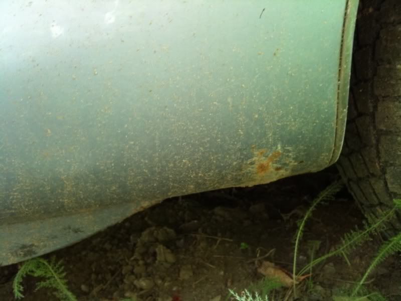

    A little blister of rust on the spare well - where else do these commonly rust?

    Rust is usually up in the rear quarters...hard to get your hand up in there. I don't like a car that has sat on the ground for a long period. It can, and usually does, promote the start of rust....some that you can see and some that you can't. I don't know if they use salt in your area but, if they do, the car sitting on the dirt will accelerate the rust. The LT1 is a good engine but, with 128K, it may be ready for a new opti spark which is expensive. May need other things under the hood too...wires, sensors etc. It is an OBDII engine. Then you have a sending unit that probably goes off at around 200 bucks. More if you want and AC Delco unit. And, while you are in there, you may find that you need a fuel pump too. The LT1, while a good engine, has parts that have become expensive. If it were me....and this is just me....I would walk away from this one. You could get lucky but, I don't see this car as a cheap winter driver. JMHO

    inner fenders, open the tailgate, you can remove the plastic locking storage box on the pass side (it literally lifts out) and the spare tire cover, that'll let you see the quarters better,.
    dr side floor goes as there's a sheild above the cat that traps salt n crap from the winter,, then bakes it,.pass does the same thing but not quite as bad,.after a year in the grass, brake lines will start popping,.from the abs pump to the pass front is a bad one it runs along the front crossmember and rots where the holddown clamps are,.
    having said all that, for $3-600 it's a fairly good deal,. drive it tho to make sure the trans shifts ok,.brakes work etc,.if it sounds like it needs an exhaust donut gasket,. be careful,. lt1's have a habit of breaking the exhaust manifold to head rear bolts, then you have to remove the manifold and get creative with a mig welder, to get the bolt out,.

    mike, only the 1996 model year is an OBDII car. 1994 and 1995 are LT1 but are OBD1
    the wagons have a habit of popping brake lines at the B pillar.
    442, if you can get it between 500-1000 id go for it. you can get your money back out of it if you decide to dump it in spring. but my guess is you will really like it (especially the power) and want to keep it.
    get it, yank the A.I.R. pump off. throw some fresh brakes on her, and a decent stereo and drive the $#!T out of it!
