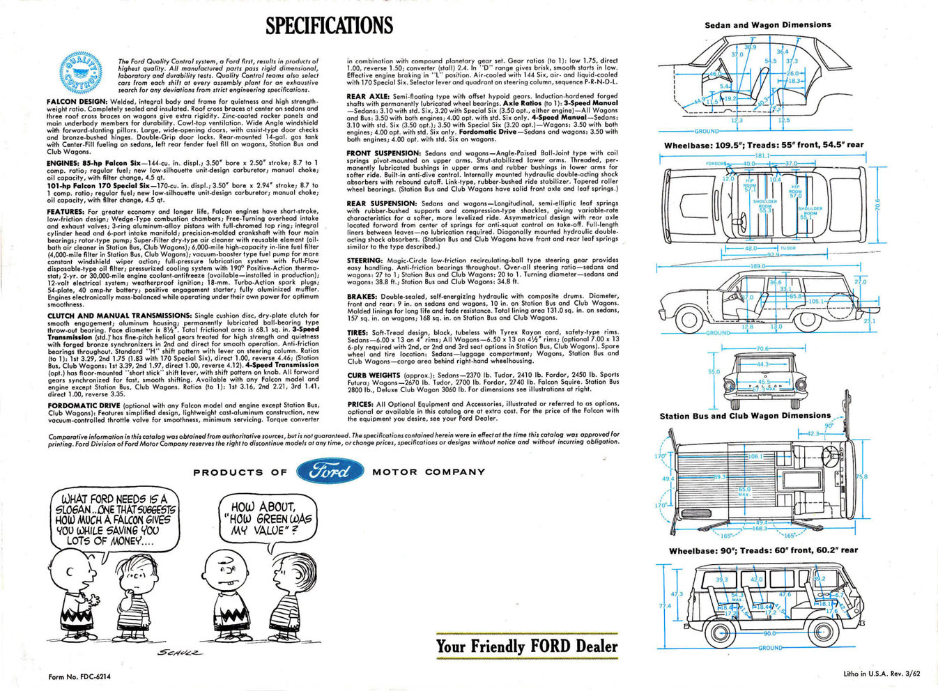

  14. Krash Kadillak
    20,657
    1,845
    Here's the '62 Falcon brochure specifications page. Clearly states a floor-shifted 4-speed manual was an option with all engines.

    14,928
    2,950
    710
    "How green was my value." God bless the memory of Charles Schultz.
