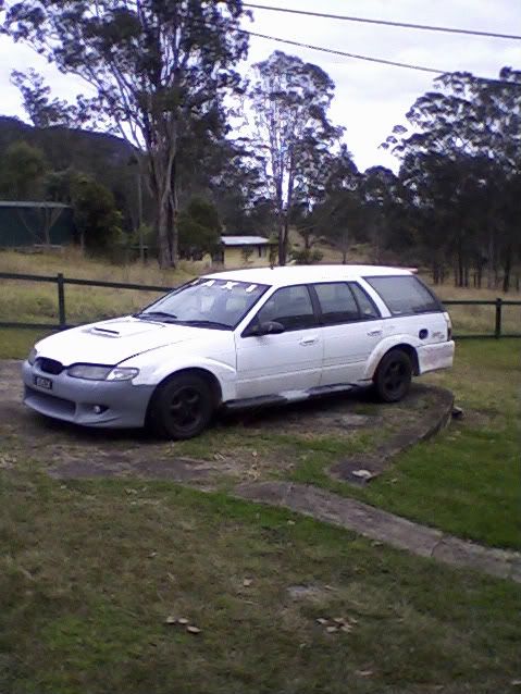

    I then purchanced the car in November 2009 and picked it up on the 30/11/2009. Here are a few pictures of how it looked.
    Despite being a taxi and having over 400 000 kilometers on the odometer it was a very clean and straight car. Fast foward 3 mounths to the day and the car had changed

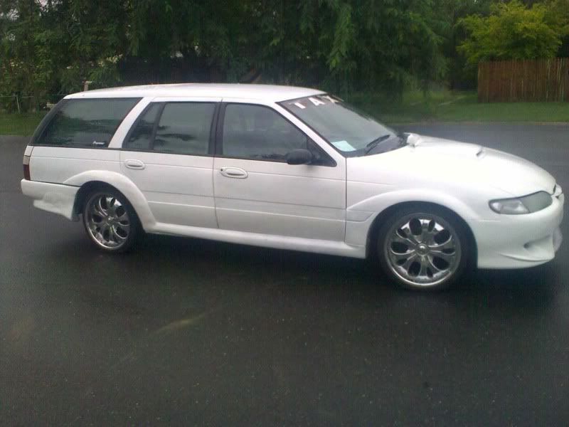

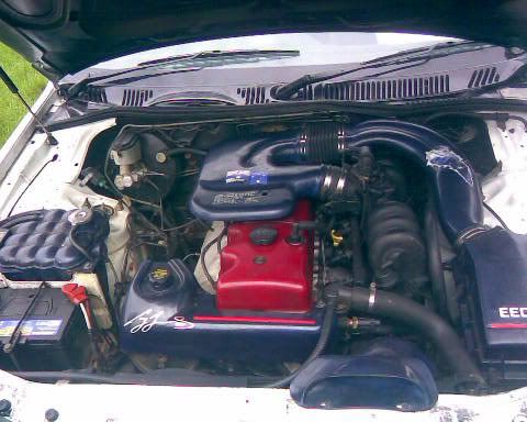

    I had fitted an after market front bumper bar from a company called Venom, fitted a set of 20 inch chrome wheels, fitted wheel arch flares and side skirts from 1992 Ford EB GT Falcon and made my first attempt at a custom rear bumper bar. I had also fitted another motor from a different car from Ford Australia called an XR6. It is the same basic motor that came in the car from the factory but work a worked head, different cam shaft and bigger fuel injectors from the factory which when new was rated at 165 kw at the fly wheel.
    Since those picture I have taken the car off the road to redo the rear flares, side skirts, rear bumper, interior, exhaust and a few other things. This is how the car currently sits and hoping the rain goes away all the body work will be done and the car repainted in a different colour within 8 weeks.

  2. Stormin' Norman
    May 30, 2007
    19,635
    32
    813
    Winnipeg, Manitoba, Canada
    Looks like a Ford Taurus on Steroids! Very nice machine.(y)

    Speaking of turbos, When this current motor was rebuilt for my previous car it was built with a turbo in mind. These motors have had 600hp pushing out of themon regular 91 unleaded with a turbo fitted and if I wanted there is a twin cam version from later model falcon which comes from the factory turbod with 310kw at the flywheel and companies who can and have regularly had them spit out upto 1000hp on a dyno.

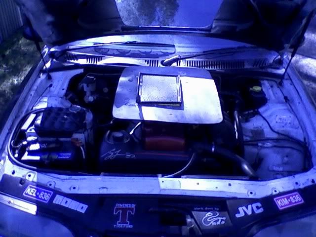

    Well I had a small win today. Next week I will be getting all the meterials need to fabricate a custom induction. It will be along the lines of the ram air setup on old mustangs that mount to the motor and poke threw a hole in the bonnet. Now we had the same setup on falcons from the early 70's but this one I am doing is different as its going onto a 6 cylinder and it will be made to suit a toyota corolla bonnet scoop which when I think about it is a rather big scoop that covers an area of approx 3.5 sq feet. Here are a few pics of the wooden mock up that I made to work it out.
    I also thought I would be a little more specific about some of the details on the car. The front bumper bar has been completely smoothed, the insides of the headlights have had parts of the reflector that arent used painted black, the bonnet scoop pictured is the toyota one. Inside the car the top of the dash and the door trims have been covered in black velour and the red highlights on the dash and doors are velour also. The steering wheel is a genuine leather Momo item with air bag and I have fitted an alloy shifter knob. The front seats are leather with grey velour inserts and are from a 1997 ford fairmont ghia. Stereo wise I have a JVc cd/mp3/usb/bluetooth head unit running 6 inch pioneer splits in the front and 6inch poineer 4 ways in the boot. The noise of the motor is helped with a custom 2 1/2 inch exhaust using the factory manifold, custom engine pipe, hi flow catalitic convertor, a single muffler and it finishes with a twin 3 inch stainless steel tip on one side. I have another custom tail pipe being made so it exits on the other side of the car as well. here is a crappy video of the sound it makes but beware do not turn speakers up to loud as it squeales in the middle of the clip. It is not the sound of the car just the microphone haveing a heart attatch.
    At the end the car is running at 3500rpm. The car redlines at 5500rpm and for those who are interested this car is using a ford ecu that was specially tuned for use in the 1997 xr6 high patrol police cars so it has not speed limiter and has help this actual car exceed 200km/h. Oh and back in 1997 the xr6 falcon was faster then the 2 locally produced 5.0L v8 four door sedans. 1 was the ford xr8 falcon and the other was holden (gm) commodore ss which both made about 180kw's but due to the added weight and the more usable torque from the inline 6 were slower then the Ford xr6 falcons

    Well this afternoon after play around with the orignal intake mock up it was dropped of at a local fabricator to be made. He hopes to have it finished sometime wednesday but said if not it will be this week. When its finished the box underneath and the hole for the filter will be offset towards the drivers side of the car so that I can use the rubber pipe joiner off the EF intake and it will also have a single backet fitted so it can be held inplace using one of the exhaust manifold bolts. Now this will actually be a short term thing so I can see how the intake works.

    I took it threw some twisties gentley at first and gradualy kept stepping it up and the brake were great as was the handling. The rear ended had a tendency to want to step out on some of the rougher corners but was nothing major. This afternoon or tomorrow morning my intake will be finished as the shop is waiting for some 3inch pipe to finish it. As soon as its on and I have gone for a drive I will add some pictures.

    Here are some pictures of the induction. The box is secure but not the filter which will wait because due to the heat from welding its warped and just needs to be bent into shape. Also the scoop doesnt bolt on yet due to me loosing the nuts for it.
    The bonnet needs the hole made bigger on the passengers side of the car so it clears the scoop and box. Here is a very short video of it. hopefully tomorrow I can have the bonnettrimmed and attempt another video.
