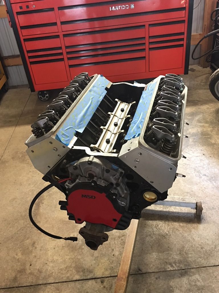

    Hi all,
    My '96 RMW has been up on rollers since December while the LT1 was being reincarnated as a 355. (bored .030, new cam/pistons/180cc Dart aluminum heads etc) I'm almost done, and eager to get this beast back on the road, but getting bogged down by the details. I could use a little help from the community (both advice and tracking down the remaining parts) Any help would be appreciated! Here's what I need:

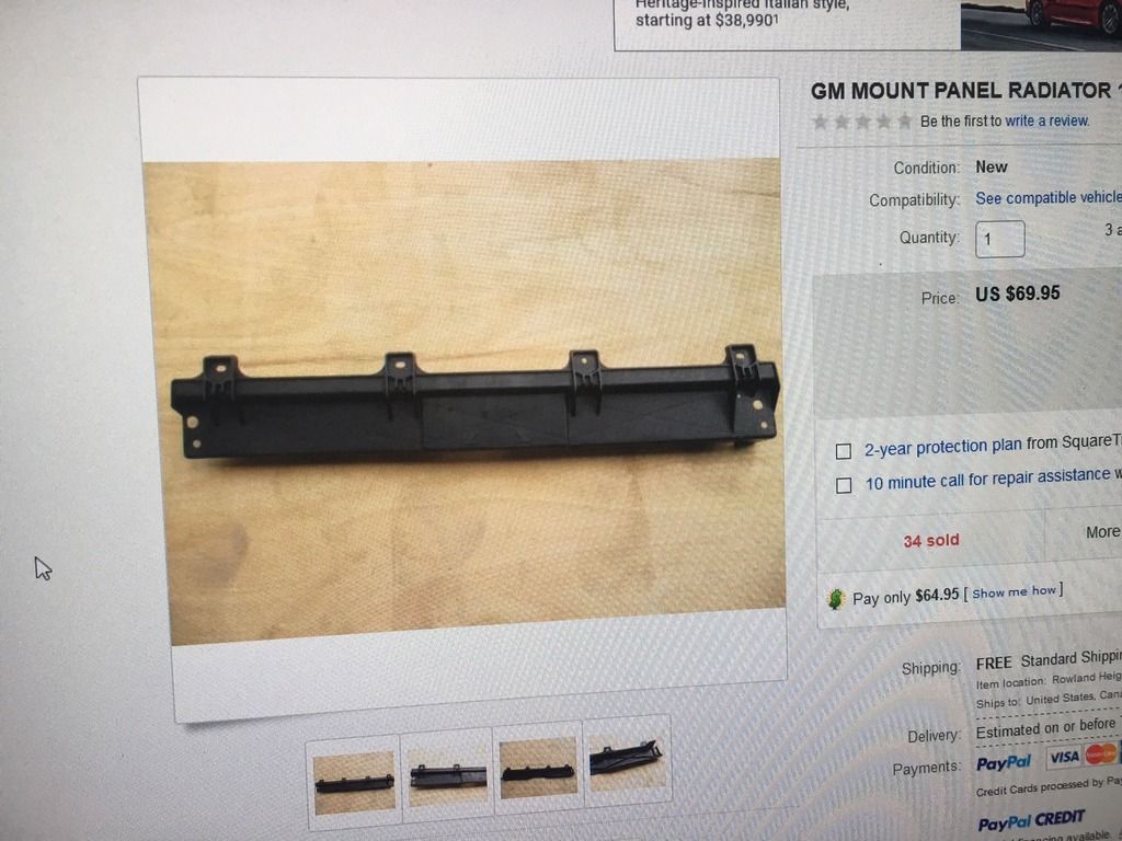

    2. This car was missing the plastic part (shroud?) that connects the top of the radiator to the cross beam at the front of the engine compartment. I'm not sure what it looked like to begin with. I included a picture of what I think might be the part. Can anyone verify that? Or shoot me a picture of what its supposed to look like? If anyone has the correct part for sale, I will buy it from you.

    4. Headers--This is the biggest question at this point. Someone told me 1 3/4-inch "Tri-Y" style headers are the way to go. If there's a way to do this without buying new cats that would be great. (i.e. bolt up to the existing cats) I'm just not finding much info on header applications for this car/engine combo. Please advise.
    5. Torque Converter--I'm staying with the existing 4L60E transmission for now. My aim is to make the car as streetable/driveable as possible given the setup (I'm not taking this car to the strip etc). I need to verify the rear-end gearing (I think its 2.56...is that the standard, non-tow package gearing?) I would welcome any suggestions on an appropriate TC/stall number.
