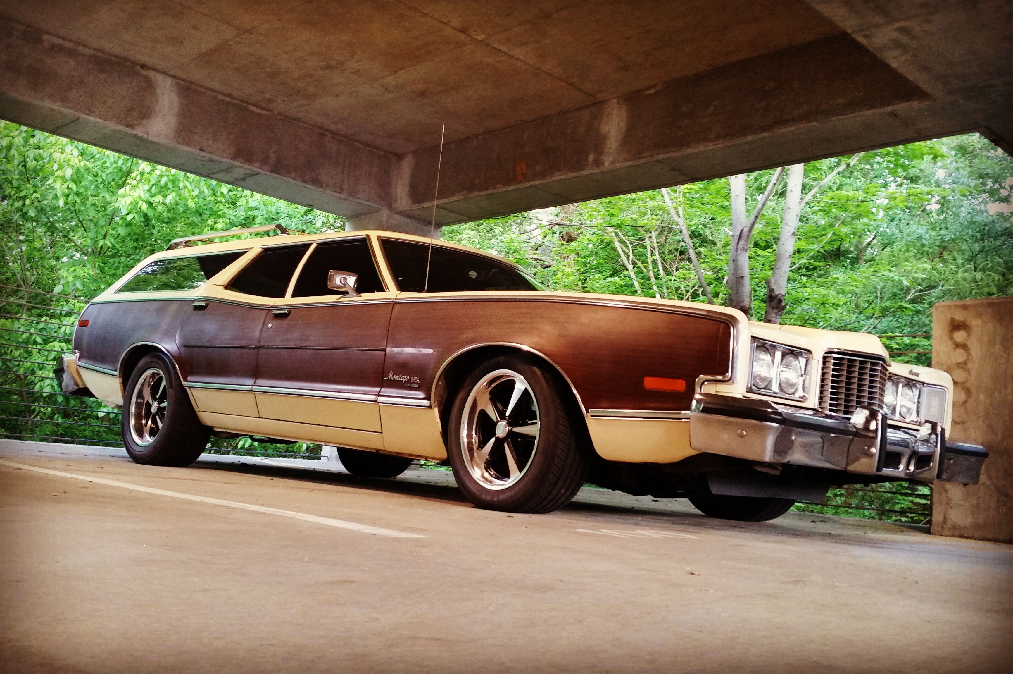

    If you're wanting a wider rim and tire on the rear, something like a 15x10 with a 5" backspace should work. Or a 15x8 with a 4" backspace. For tire size, 275-60-15. I think a 295-50-15 would be too short for your big wagon. Here's a pic of my wagon with a 15x10 on the rear with 5" backspacing. Tire is a 305-50-15, which is no longer available. 295-50 is very close. I felt it was too short. It was more obvious when viewed from the side.
    EDIT: After looking at the look you might be after, you might like the 295-50. But, the rear of your wagon will need to sit low, so there's not a gap. That's what I didn't like about mine.

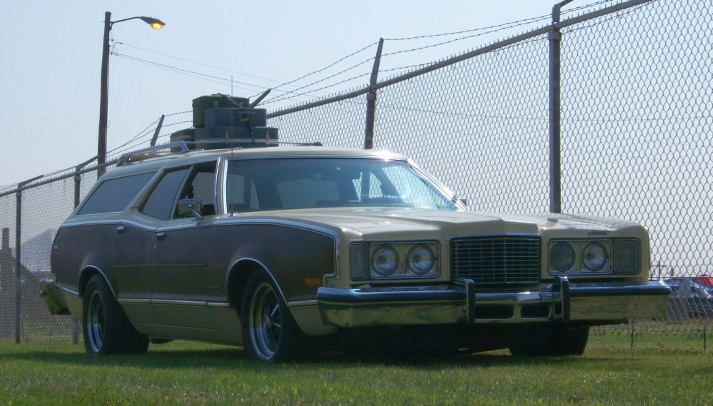

    Funny you ask about 17" wheels. Soon after I took that picture a couple of years ago, I changed to 17" wheels. Here's how it looks now.
    I'm using US Mags Bandit U109. Rears are 17x9 with +8mm offset (5.31" backspacing). Fronts are 17x8 with +1mm offset (4.54" backspacing). I highly recommend US Mags brand. They're great quality, have great selection, and priced much better than American Racing brand. Just my opinion.

    Rear tires are 275-55-17. Fronts are 235-60. 245-60 would work too.
    The wheels specs came from an Ebay listing that I had found. But here's a link to their website with their specs. Virtually the same.
